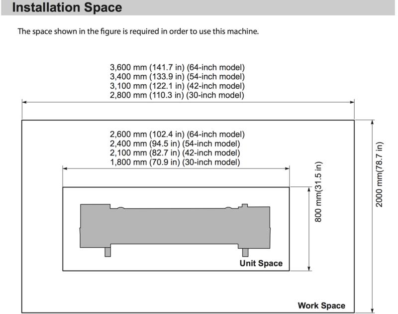

The setup guide for the VS series gives some recommendations... see the image attached for the various machine sizes and Rolands recommendations.

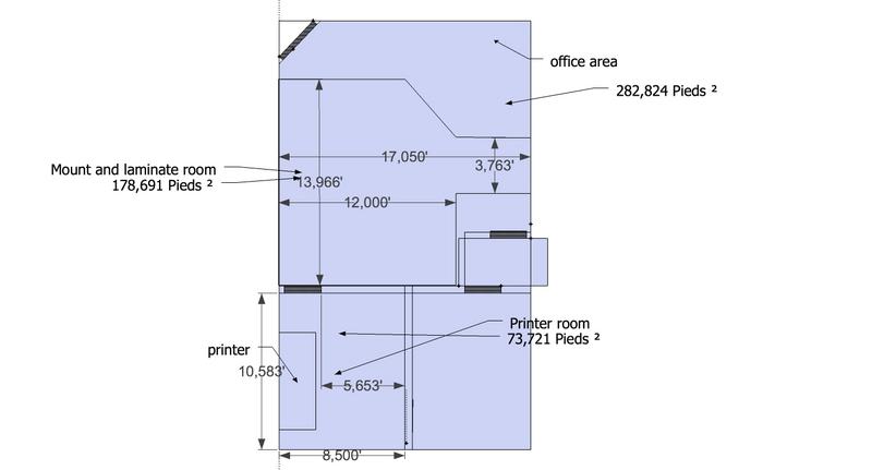

The design at this time looking like that.
Printer room 9'x 11' and laminate and mount room 13'x12'.
Did you seems agree and it's was correct for starting ?
The room not mention is not avalaible for the business area at this time maybe in a few month or next year .
I start my own shop im in build process right now.

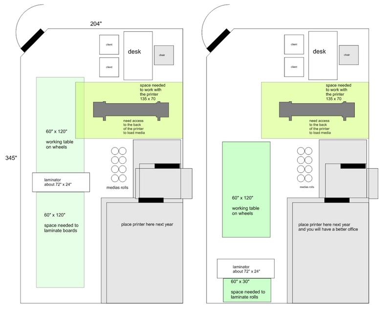

J Hill Designs
you need room behind your printer as well
as for a 12' "mounting room" -- if you have the laminator in the middle, you can only mount to ~4' substrates...
Guimb0
Yes but right now i can't access to this area :frustrated:maybe in a few month.
For work,printer and office area no divisions was made. If you have other idea feel free to keep me in!
