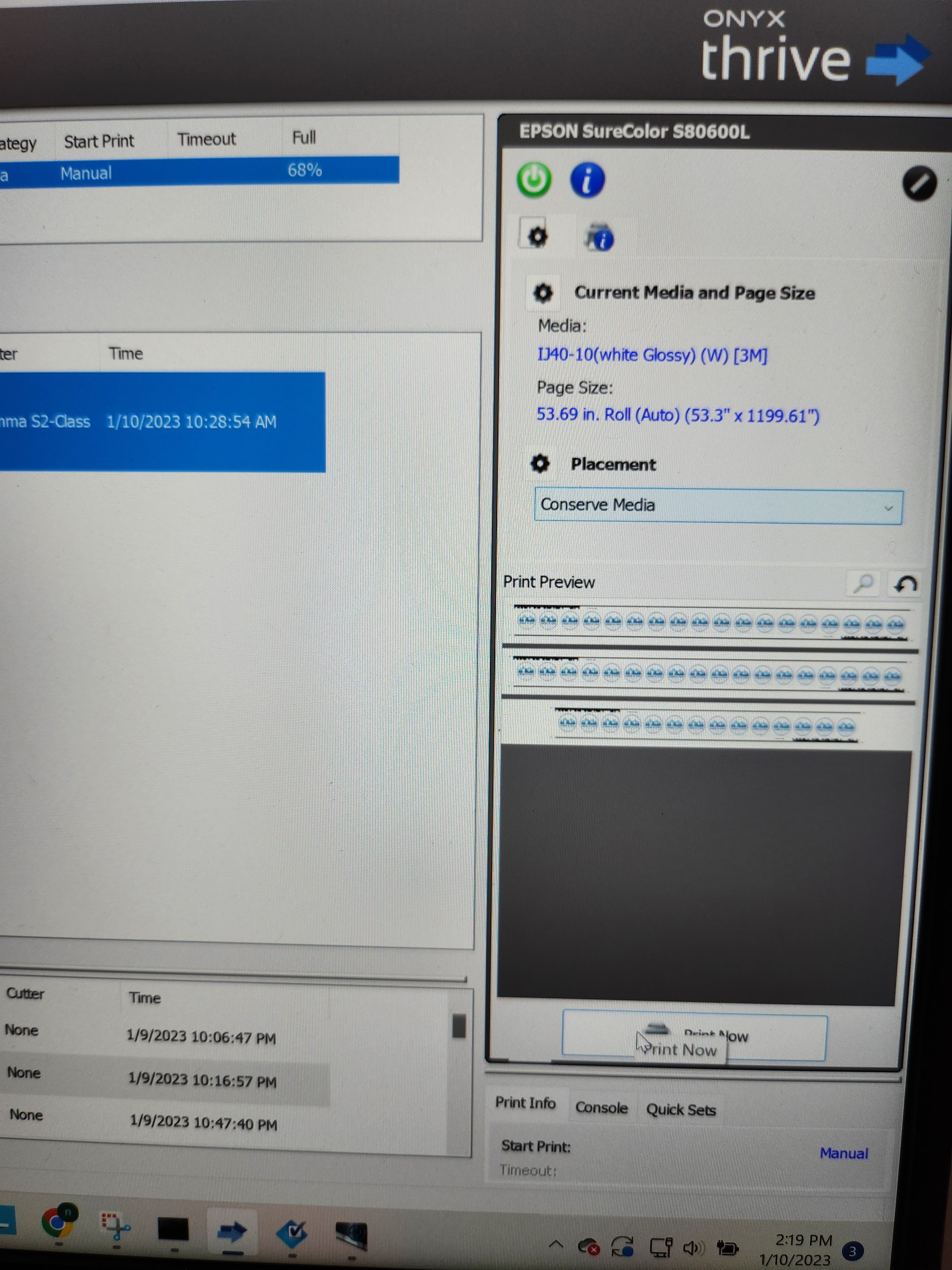

In the meantime, I have print working as well as cutting on the summa with barcode. However, if I have one job and and have 50 copies, it will place like 20 copies on 1 row with the barcodes and then the 2nd row will have another 20 with its own barcodes and then the 3rd row has 10 copies with its own barcode registration.

Hit that cogwheel next to placement. You have some "print rows" option selected.
