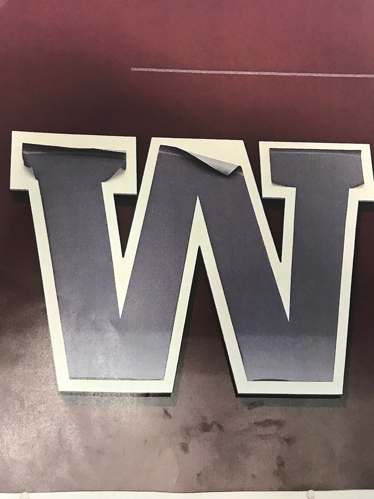

We produced a large sign with custom routed PVC lettering this February. This was an interior sign. Our customer just informed us that the vinyl on the cut PVC lettering is peeling away from the PVC. I've attached an image. Some details on the materials used:
-Substrate used is 6 mil white Palight Foam PVC
-Vinyl used is Avery MPI2923 Matte EZ with a Lamex Luster UV lam
-Vinyl was printed and plotted on a Roland SolJet Pro4 XR-640
The only reason we could think for the peeling was maybe that the grey was printed edge to edge? We've used this method before without any problems, which is why we're scratching our heads. Any insights would be greatly appreciated.

Did you let it fully out-gas? For a saturation like that I would think a minimum of 24 hrs. Preferably 48 hrs. Did you use application fluid?
Normally edges lifting all around like that is from the leftover solvent gas(Trapped under the laminate) leaking from the edge of the vinyl and softening the adhesive at the edge.

i am curious on the location of this sign, is it in sunlight even through a window? looks like the vinyl has gotten warm
You need to verify the compatibility of the laminate. Since you laminated the vinyl I assume you didn't cut it too soon before the outgassing has occured.
Resembles just too much saturation of ink and as it's now fully curing, it is starting to go back to it's original shape/size. The vinyl you used is for short term or medium usage with proper laminate. Once that starts..... there's no stopping it.

prepped with 91% or better alcohol first? What brand PVC? I've gotten some cheap stuff before that vinyl did not stick well too...it was the stuff with a clear liner. Never used it again.
NateF
In nearly 5 years of doing this, I've only seen vinyl peel off PVC once like that - and it was Avery 2903. We switched to 3M IJ35 and IJ40 and have never experienced another problem with mounting prints on PVC. It really irritates me - We have a local sign supplier that has the best service but only carries Avery products. I would give them all my business if I could, but I just don't want to use Avery printable films any more.

What eahicks said. Particularly if the PVC is unpainted (my eyes aren't good enough to see if it is).
eahicks
Unpainted PVC isn't an issue....we mount to PVC every day. It's the cheap stuff that's more porous than usual that I've had problems with.
