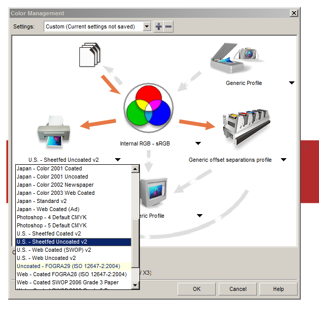

I've been trying to get what I see on the monitor to be the same as what comes out the printer. I've made some good progress and the trick seems to be inside the little box attached as a photo to this post. I tried quite a few of the profiles in this box and the one highlighted is the best so far. Is there a proper Roland one for this? If so... where do I get it and how is it installed?

That's a pretty old version of Corel, and that little wheel has thankfully long since been retired...
But the bottom line is that the only way to do what you're trying to do is to first profile the monitor -- correctly -- and then view as a soft-proofing condition through the actual profiles to which you're printing on a particular media.
The profile you've selected there happens to be the default CMYK working space for most applications these days, however, unless you're printing on coated stock on a heatset web press, it's not your printer profile.
Your actual printer profiles are in a file somewhere in your RIP directory. Where exactly depends on what RIP you're using. It's possible to point that wheel to them, but it is pretty cumbersome.

Thanks Mike. I'll dig around a bit and see if I can find the correct profile. The profile I selected is light years better than the one I was using but I expect the proper one would be better still.
