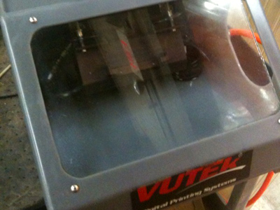

Has anyone bought one of these. I operate a Vutek Pv200 machine, and have several jet packs with deflected, and missing nozzles. Vutek told me I have to buy new Jet packs ($5000each) which I refuse to believe that the jetpacks can't be recovered. I tried recovery in the Vutek supplied recovery station, and no luck. I did some research and found this product. claims to recover 90% of all clogged jets. also has a 30day money back policy.

if you go down to the purchase box it has an option for the pv 200. It's the Vutek Recovery staion that came with our machine, 2006 sounds about right. What kind of PSI should I run the head conditioner throught the jet pack, been running around 60-80, with no real luck. How long do you run the cycle? do you use just the head conditioner that you use for daily maintanence, or is there another liquid I can use? I just want to exhaust all possibilities, before buying a new jet pack, and the printhead 911 machine seems like it is a possible option, I just don't know of anyone who has purchased or even used on of these.

yeah, that's the correct machine. do you think there is damage to the jet plate or just clogging of the nozzles?
Here's how I would clean:
1) Load fresh "maint fluid". Clip in head, run for 15 minutes.
2) Scrub with supplied brush
3) Use the "blow" function of the cleaner to blow into all the nozzles going end to end a few times
4) Scrub with supplied brush
5) Use the suck function to slow suck all the nozzles going end to end
6) Scrub with supplied brush
Check for improvement in the flow leaving the printhead.
Never had to disassemble a 200 printhead, but did so to many of our 3360 printheads and cleaned the surfaces between the jet pack and the jet plate which is where the majority of our clogs on the solvent were. Obviously, this will void your warranty but if your printhead is bad and out of warranty already then who cares. I've dis/re - assembled at least spectra 15 printheads for the 3360 and never damaged one in the process. All you will need is small screwdrivers.
