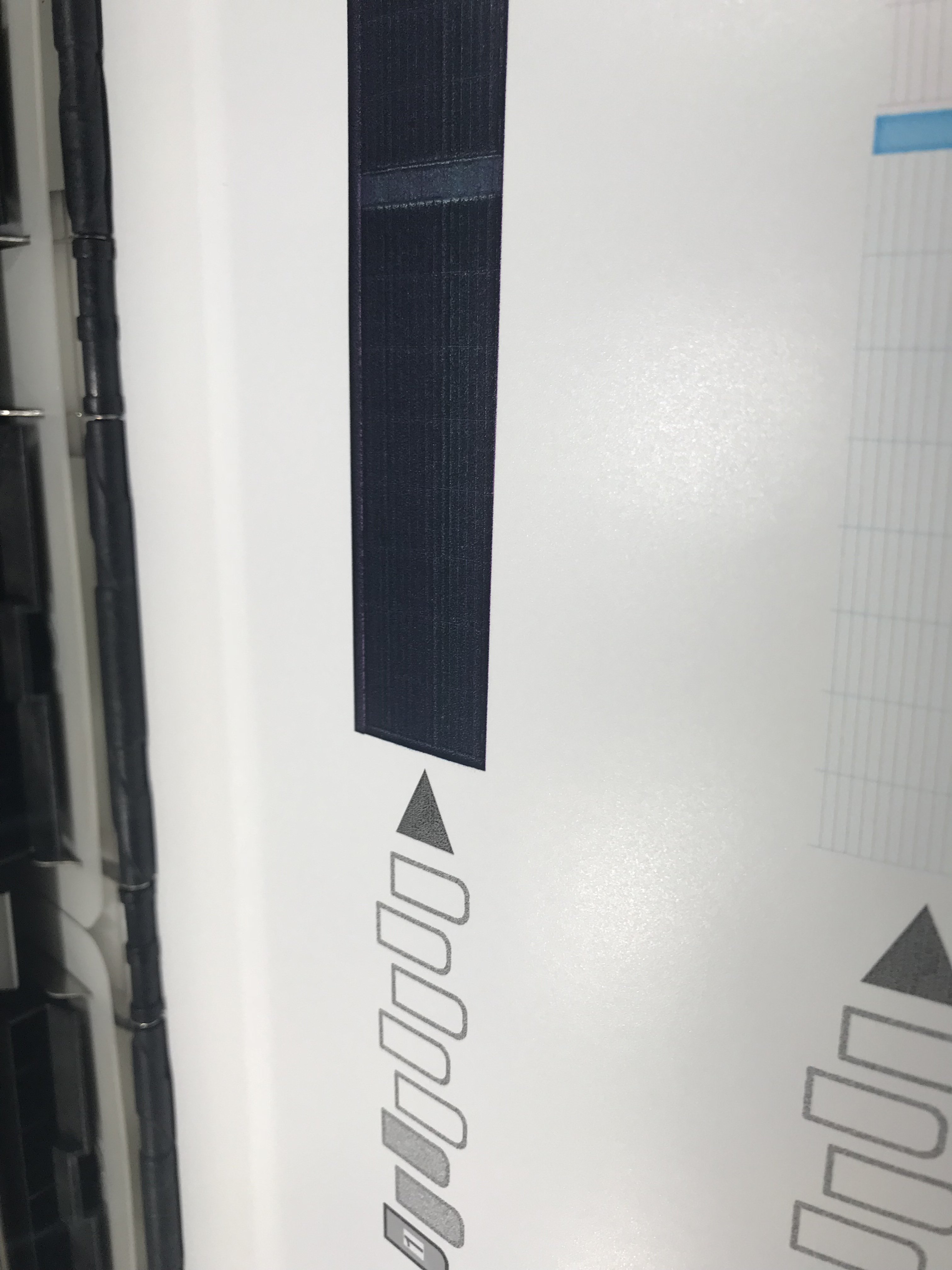

hey guys, so I ran into a problem this morning I've been trying to fix it by myself for almost 5 hours now with no luck at all.
after changing the magenta ink cartridge (for the first time) the machine started printing with horizontal banding and it hasn't stopped even though I've already tried (a couple of times already):
optimizing image quality
-calibrating color
-automatic printhead alignment
-cleaning all printheads

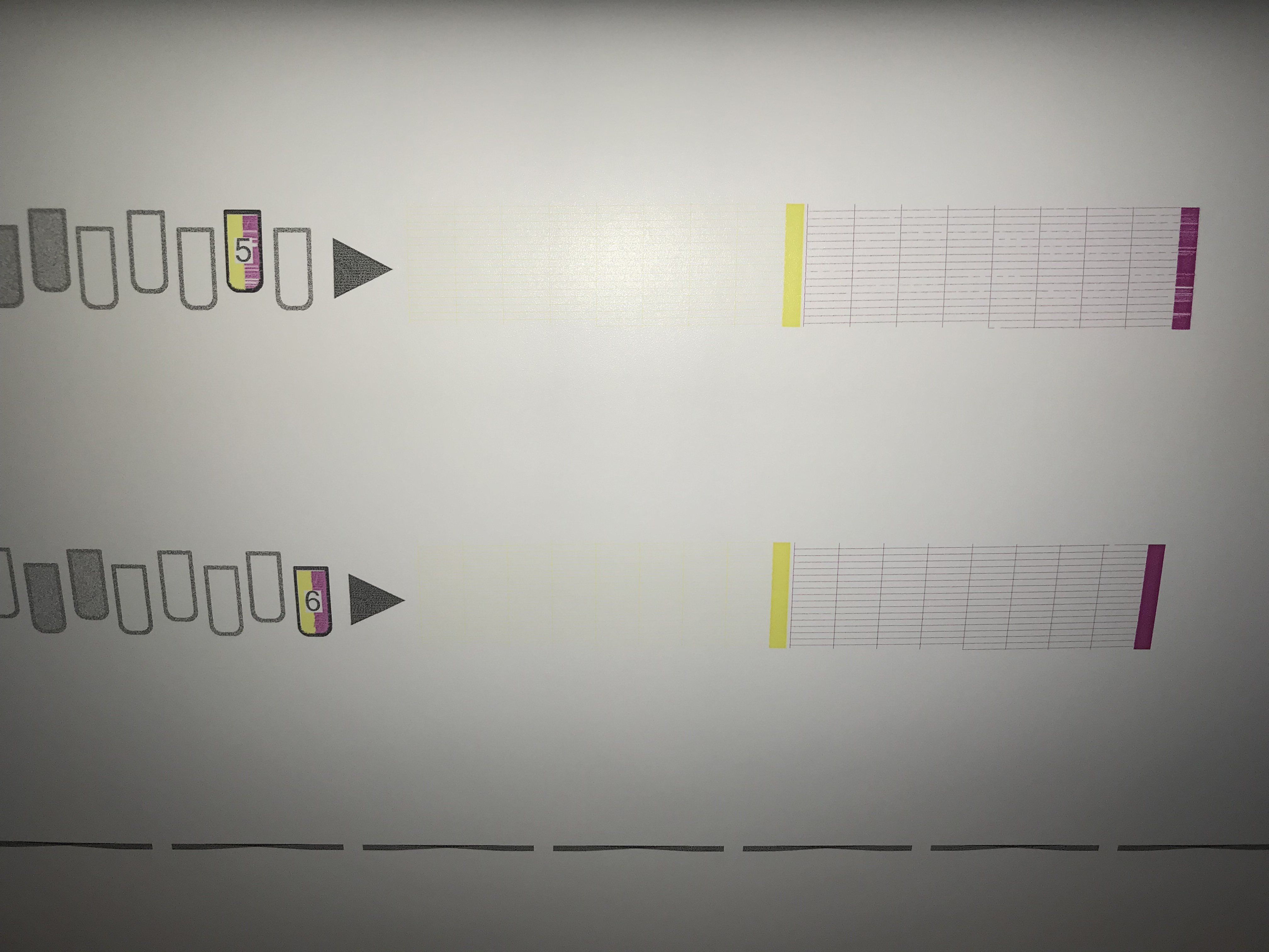

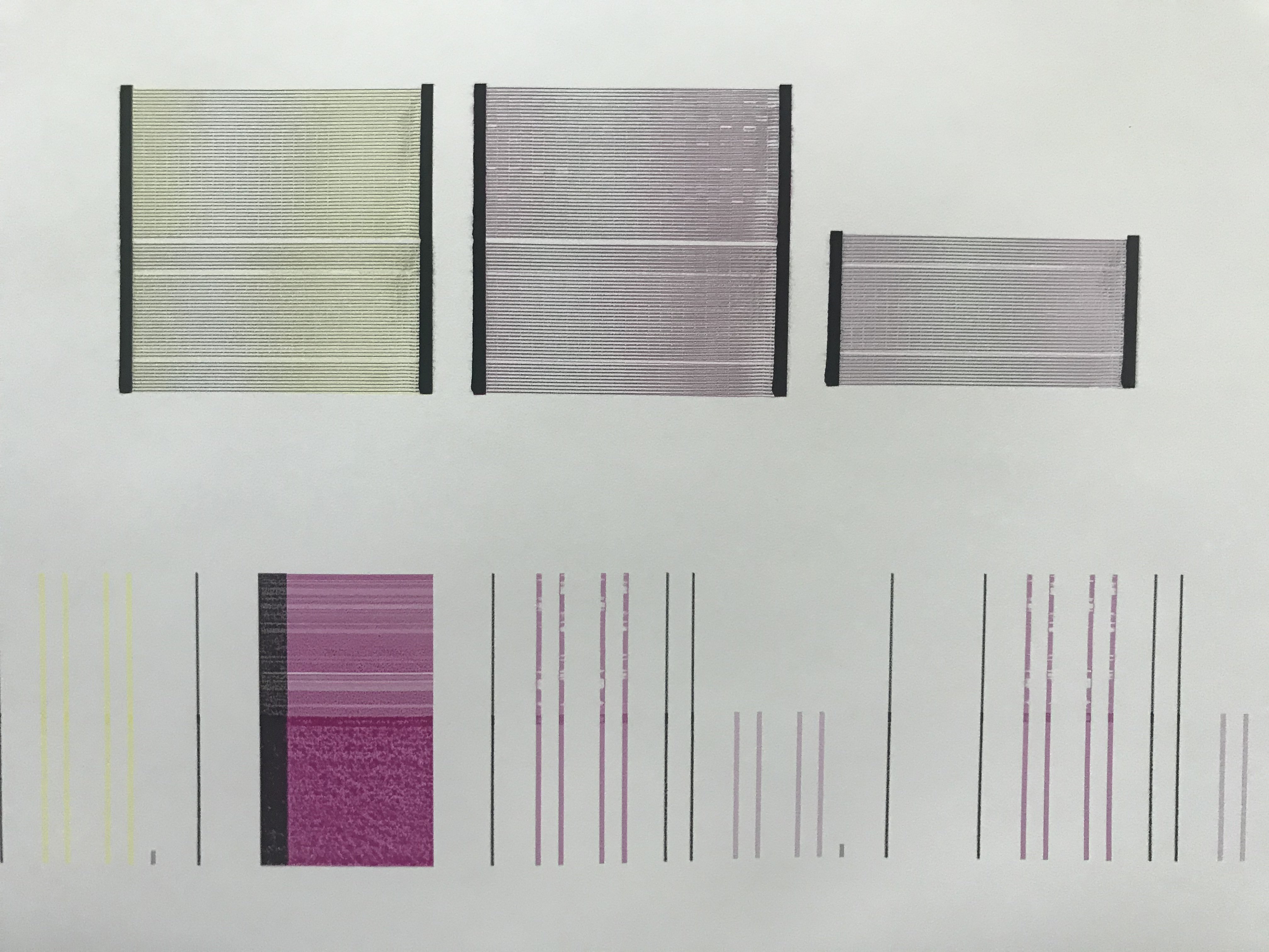

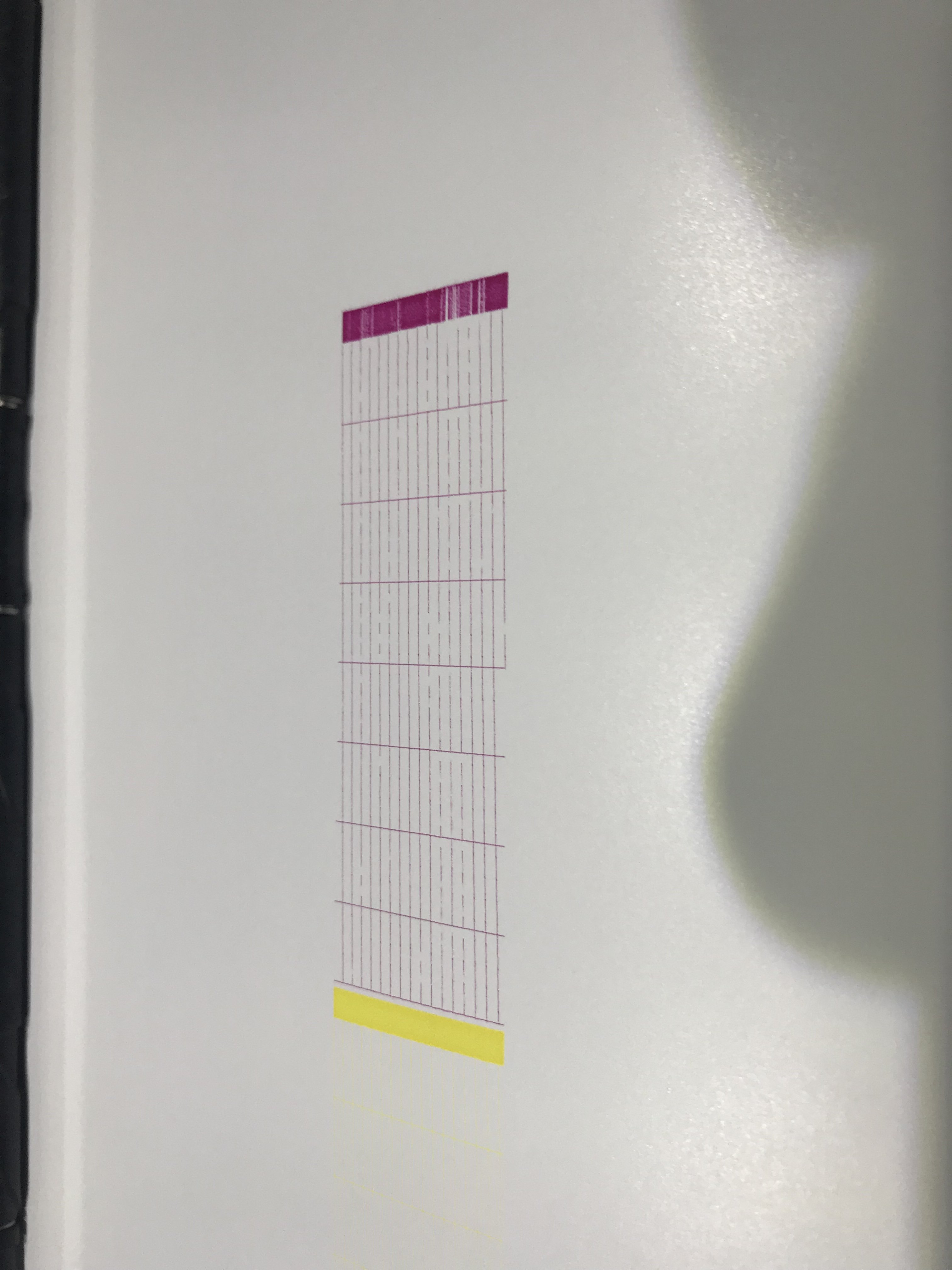

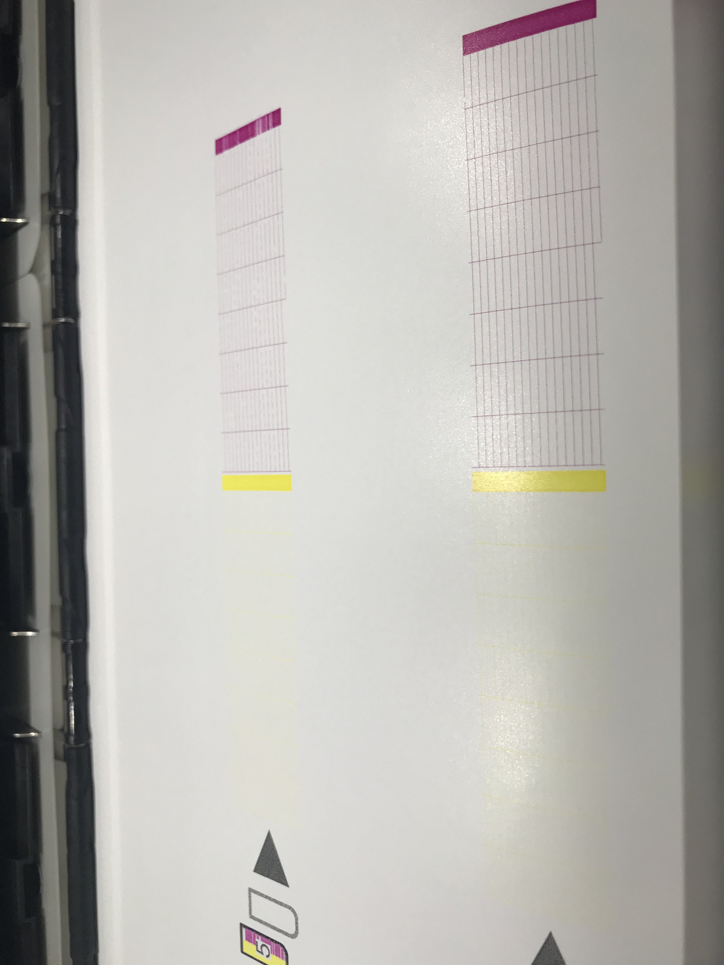

I ran printhead diagnosis (I'm attaching photos in the next post) and it seems like printhead number 5 (Y/M) is the problem, even in the printhead alignment prints you can see serious banding and spaces/lines not being printed.

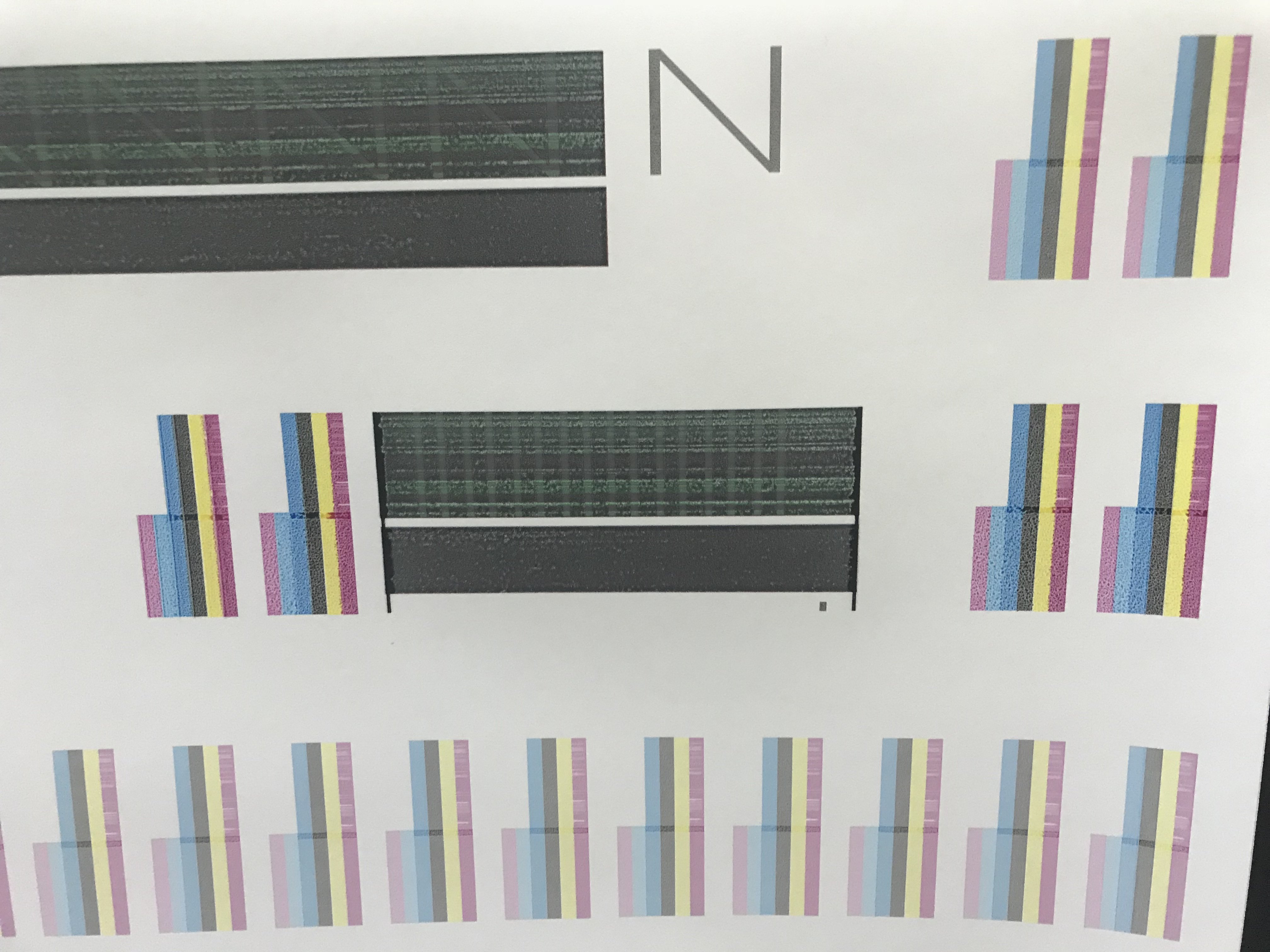

optimizer prints in tests look off too (i'll attach photos)
I also cleaned the "electric parts" in the carriage and printheads with the carriage interconnect wiper.
I've tried everything I can think of and sadly my tech support is no good.
It makes no sense to me that a printhead would get damaged after replacing the ink cartridge, is this even possible?
All help is very appreciated.

First time I see hints of magenta on the optimizer print tests too.

how much ink have you put through the print head? Might just be bad luck that it went out the same time you changed the ink. It looks like a bad head to me. I would just go ahead and replace it and see if that works.

It’s not uncommon with these heads to have multiple jets out and keep running. If you call tech support, they will likely have you run a force drop detection and then run 4 straight cleaning cycles and then another drop detection test to see if it gets the detection number under 200 or something. Then they will advise if they will be sending you a replacement head.
If you ran the heads out of ink, it’s highly possible that the head may not come back and needs to be replaced. Always keep an extra set of heads in stock. They tend to go bad at the worst moment.

update: replaced PH, all back to normal now - thanks again everyone for the help.
