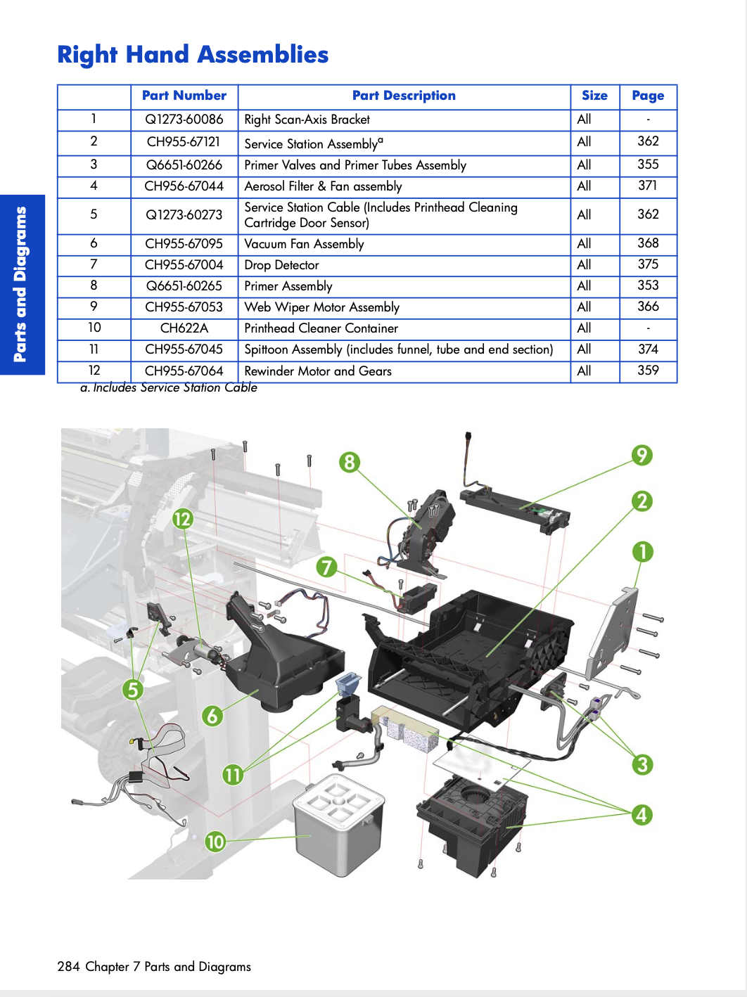

rassym
Check the primer assembly. Its probably missing the rubber stoppers, not allowing the printheads to properly prime. Sometimes it just affects one head instead of all of them.

rassym
Just replace if any are missing, should be about $100.
Reveal1
It's been several years, but we once had an HP tech spend a week throwing parts at our 25500 and this was the eventual culprit. He left after replacing and we started having problems again; turns out the caps need to be aligned to the priming tubes (may be wrong term so check your manual) which we were able to do as outlined in the service manual. I think this is why HP no longer sells service manuals; they don't want to lose revenue as most of the maintenance tasks are not really all that difficult if you have the manual.

Just saying that it can be the primer but it's very very unlikely that if you have the head open and in good condition that it would not be open again next day because of one priming not done successfully...
MachServTech
That's not my experience. The primer does cause this issue because it actually de-primes the head when it doesn't seat properly. also, the priming assembly is a pain in the ass to replace.
