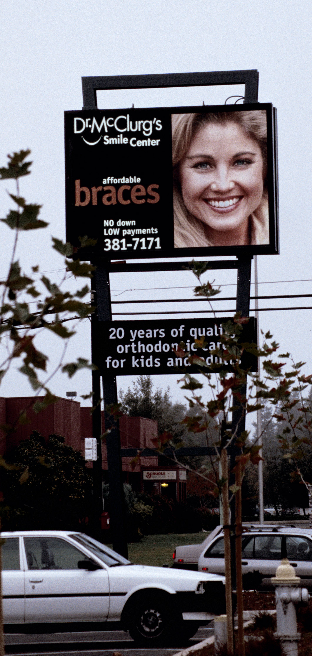

As most have said - the proven way to do this is with two printed layers (per my 3M Scotchprint training over 20 years ago). The first is printed on a clear vinyl layer applied to the acrylic. The second is printed on translucent vinyl and applied over the first. Both prints are at normal density using a standard profile so you get the benefit of increased contrast at night, with proper daytime color. No special profile needed. The top layer gets laminated.
You float the top layer over the first with a lot of soapy water solution to prevent premature adhesion.. done with a light source to help align them. 3M translucent films have an adhesive that is friendly with this process. Tip - tape the vinyl along one edge and pull the release liner off the vinyl, not the vinyl off the liner (that stretches the vinyl)... do not use heat.
Its actually pretty easy (but messy) and the results are well worth it. but you must process the vinyls in the same direction.. do not rotate one from the other.
PRO TIP: you can do this process in reverse on second surface! The clear print becomes the viewing image layer (printed mirror reading), and the translucent (also printed mirror reading) becomes the diffuser/contrast layer. Second surface improves lifespan, eliminates the need for laminate in cabinet signs, and makes a VERY sexy sign with rich colors. If a sign can be sexy.
PRO TIP: You want to avoid any use of screen patterns in your rip, as they will cause moire, stick to stochastic patterns, or better yet a fixed dot random placement (FDRP) if your rip supports this.
Yes this uses twice the vinyl, but you charge 2.5x the price - its a premium for this.
ive produced 12 ft by 30 ft signs with this process.. attached is an 8'x10'
