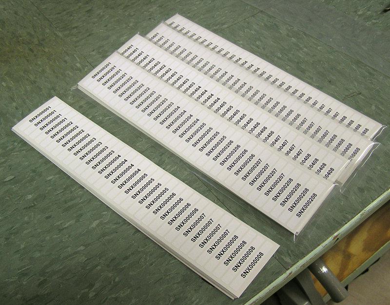

Omega has had an excellent auto number function since the first version of Graphix Advantage back in the early 1990's. Here's a current job that is dual serialized as 1,000 sets of 4 identical serial numbers in order and finished in vertical strips.
