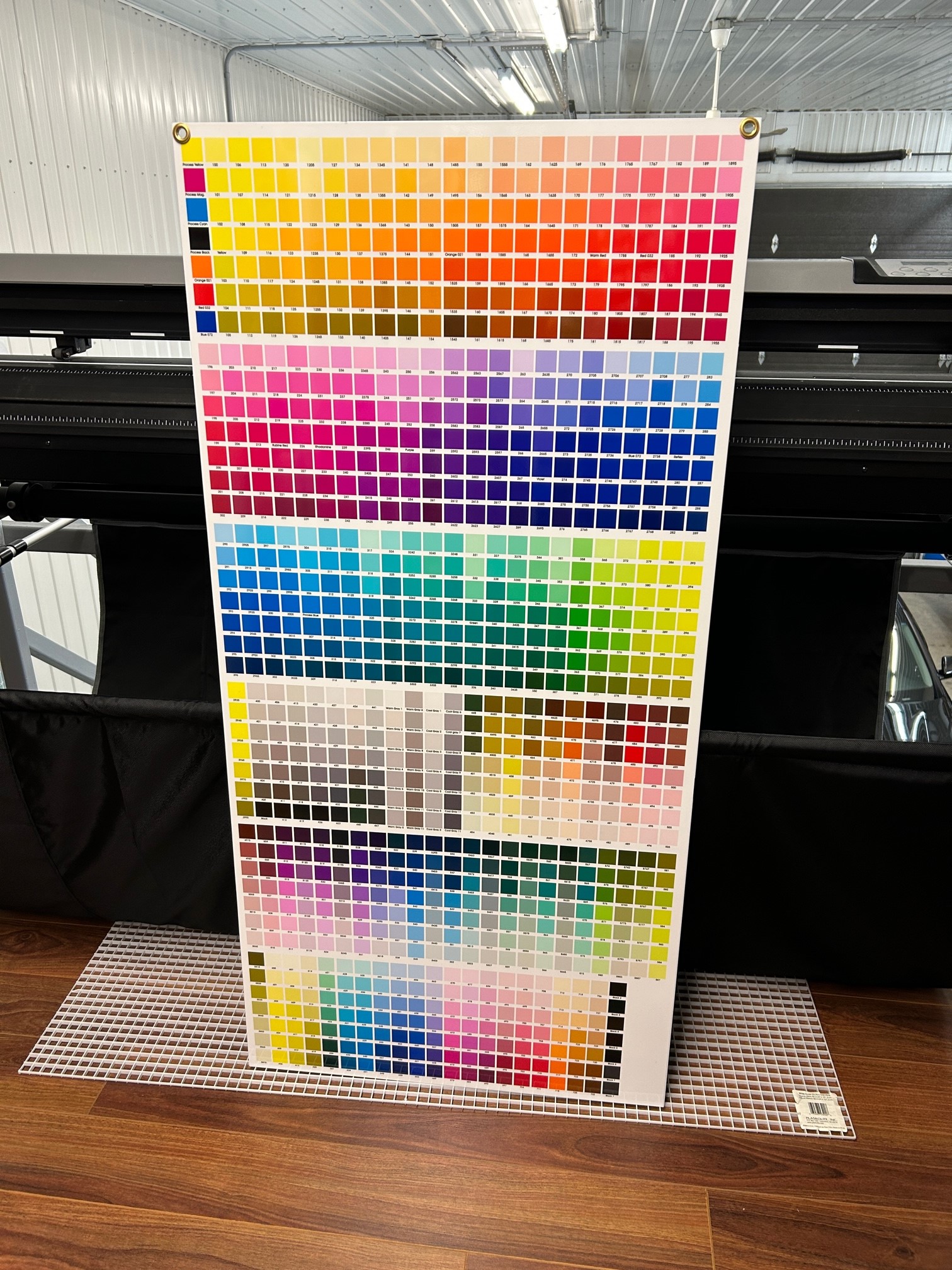

Laminate film also influence the final color. So that being said, I have printed different charts (Pantone, Pantone CVC, Roland...) on cast film (because that's what I use the most) AND LAMINATE 'EM so when I truly wanna match to the closest possible, I go outside with my printed/laminated charts to compare my colors and pick the one that best match under mid day sunlight. They are on AluPanel for easier handling
