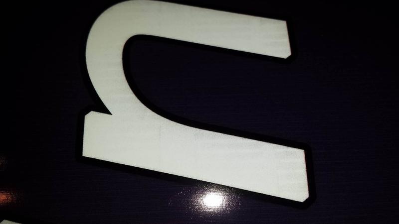

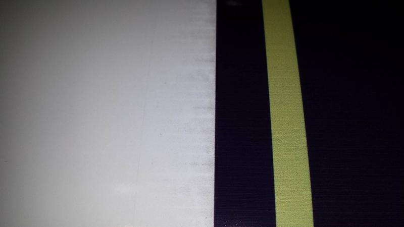

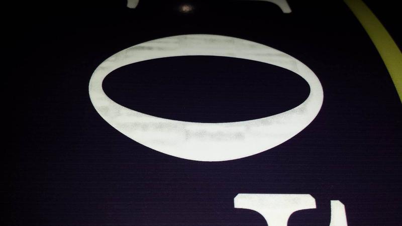

Printer is making a haze only to the left and right of printed areas, and only where the rollers touch. I cleaned all the rollers, the print head. and there's no static issues. Made heat adjustments, no difference.
:frustrated:
401Graphics
Mutoh 1204 running flexi sign pro 10.5
3rd party inks. Media Arlon 4500LX Gloss
401Graphics
ok well i put the head from 'high' back to 'low' and it printed perfect. i guess thats the issue. even though ive always printed with the head up since i got this printer, and never had a problem printing.
