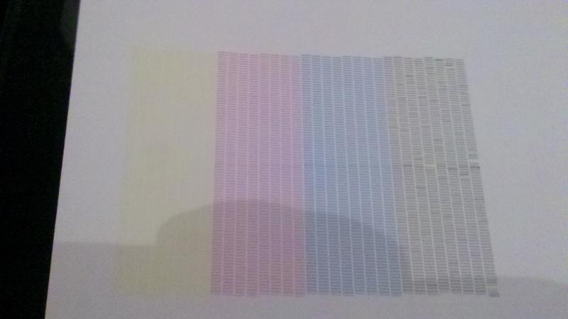

yes, I have dogs and I have to clean around the heads quite often.. but I cleaned them twice last night and did a powerful clean today, still a little "fuzzy" when printing the black. I will post a test print. thank you!

Wow, thanks John the encoder strip was pretty dirty. (that is the stainless metal piece bolted above the rollers right?) I am posting a test print.

Lots of drops and deflection on the K. Might want to gently dab that head with a saturated swab, then wipe down the wipers with the same swab. Then fill the capping station with cleaning solution and park it for a few minutes. Follow with a powerful cleaning, and another test print.
My SP540V has been put through the wringer and the K head is still good. Nothing like what you are showing.
Last thing is if you are using a 3rd party ink. You may have nozzle clogging due to variations in pigment particle size.

still printing and the black isn't printing as much coverage as the other spot colors.. anyone have any idea what I can try??
