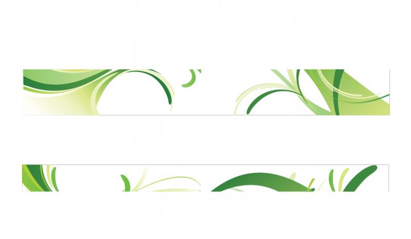

I have a VS300 roland
I m trying to print a wall flair but it is only printing the crop mark even if I m seeing the print on Versawok, it is like there is a white layer in front of what I m triyng to print
I did a Roland print test everything is ok
I m adding the PDF file that I m triyng to print on my roland
Help would be very appreciate
Best Regard

French guy
yes
I find a temporary solution I m working with a ESP file
but there is a black line around it when I m printing

Your PDF file is just a white box
Not if you open it in Illustrator.
Joe Diaz
Okay, so we know it opens in Corel and Illustrator, but doesn't display right in Adobe Reader. You are saying it wont print too? It appears you may have found a size limitation to the pdf format... or at least how certain programs work with PDFs. When I opened the file and saved it as a pdf at actual size I got the same results you did. Now when I shrink it to 50% of actual size then it displays right in the Adobe Reader and I'm betting it would print fine too. So perhaps splitting the file up may be the solution. Or perhaps scaling it up in Versaworks if that's what you are using to RIP.
Oh also, the black line you are having an issue with in the eps. was in the file when I opened it too. Oh and my color profiles are probably different than yours, so if the attached file looks a bit brighter that would be the reason.
  • hault_rev.pdf
John Butto
Your fit to artboard bounds cannot be bigger that your canvas size when you save to a .pdf from Illustrator. Therefore you get the blank page.
