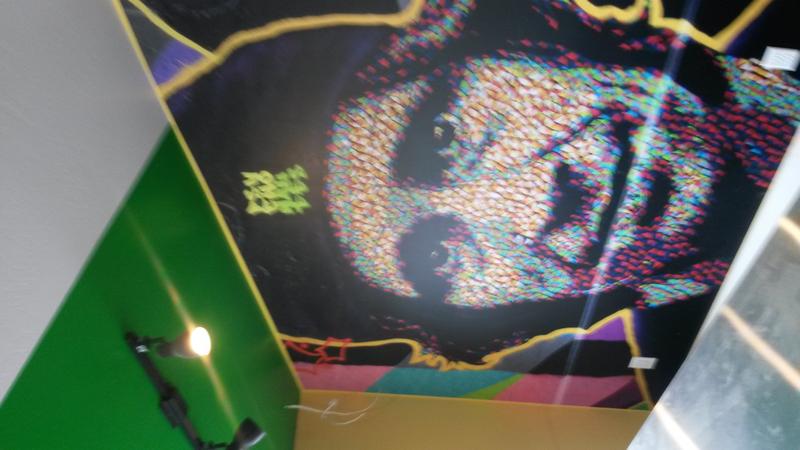

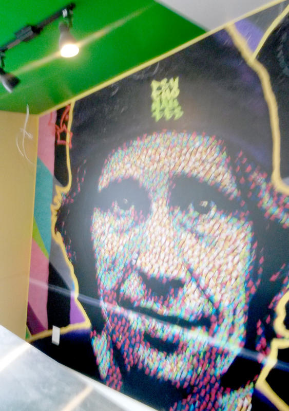

I did my first wall mural two days ago. I have a picture. It was 8 feet wide by 10 tall with an angles top edge. I used Oracal 3651 with matte laminate from Signs365.com and it turned out perfect. This is in a Restaurant so I washed the whole thing down with alcohol when completed to demonstrate the durability. This is going to be edge lit with LED's with a 3" inside trim panel.
