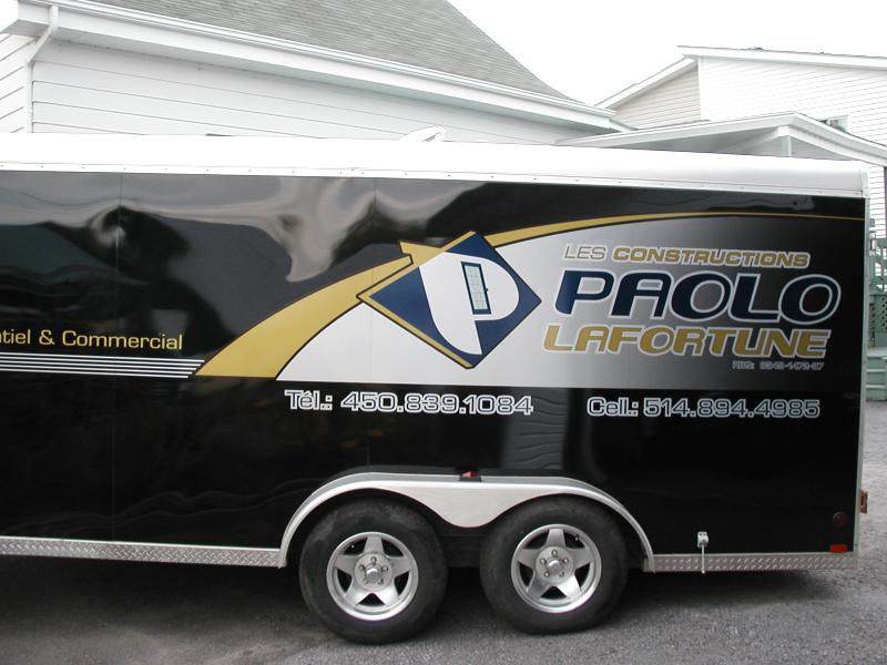

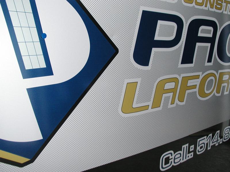

when I'm trying to print red-to-black fade, it creates a weird "transition" color in the middle. The only way I had found to print a nice fade w/o colorshift is by doing it with dot fader but this file is going to be too big for software to handle.
Here's one I've done few years ago...
(black gradient + translucent colors on silver met.)

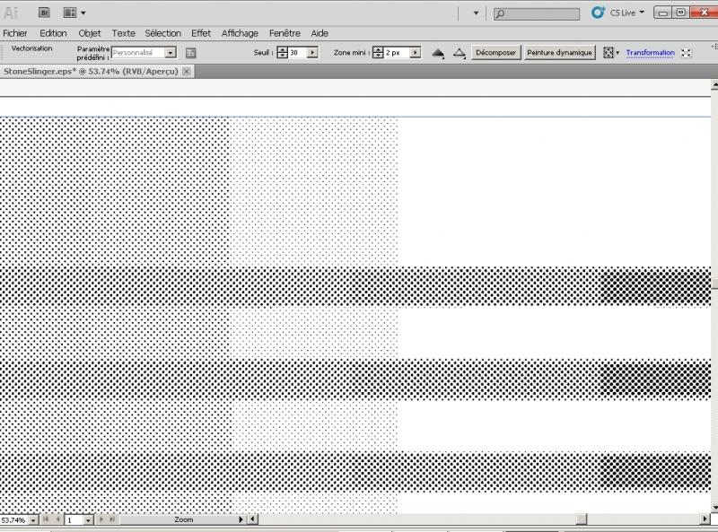

File is too big, Illy cannot handle it until I dropped the raster resolution to 72dpi but the dot are now from different shapes and the fade is stepped. Badly. (see attached screenshot)
I turned to my trusty old MAC where the Vectoraster software is loaded (Mac only...). I've been able to set the numbers to an acceptable result. File is 31Mo and contains 5 493 270 points.

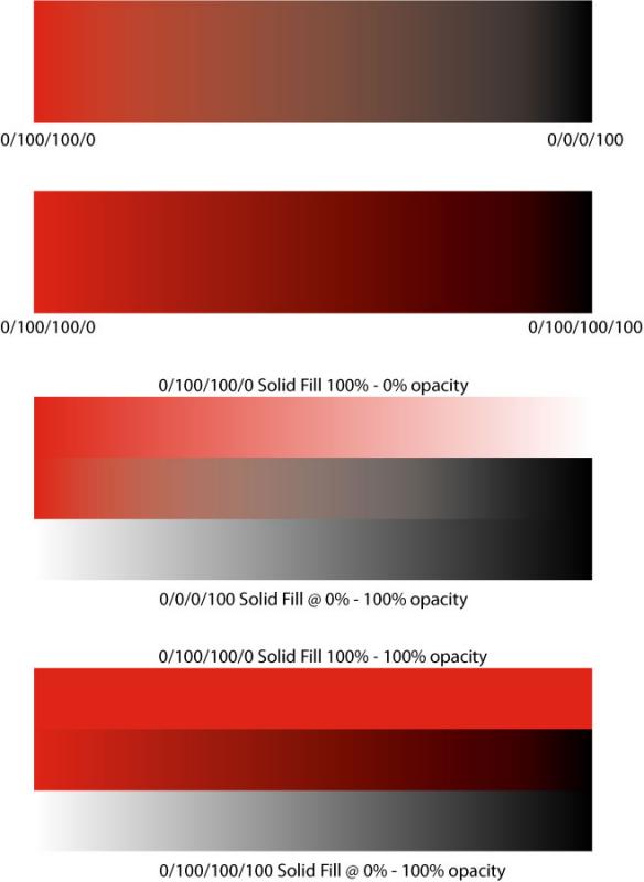

When creating a blend gradient, say from red to black in cmyk, you have to consider all 4 channels.
If your gradient starts at o/100/100/0 for read and you want it to end in black do not make the black end 0/0/0/100. To achieve a correct fade/blend your black end of the gradient should be 0/100/100/100.
otherwise your "weird in the middle" is where the red and yellow channels are fading to 0, and the black channel is just starting to pick up from 0. Therefore there is no "100% solid" fill at that point and things look weird as you're taking away 50% from both colors there in the middle, and neither are happy; there's just no color data.
Printing a gradient onto a solid (the topic of this thread) should help illustrate this point, maybe better than I can explain it. See my attached illustration for further explanation.
If you've ever worked in offset printing and used duotones, hopefully this makes some sense to you also.
