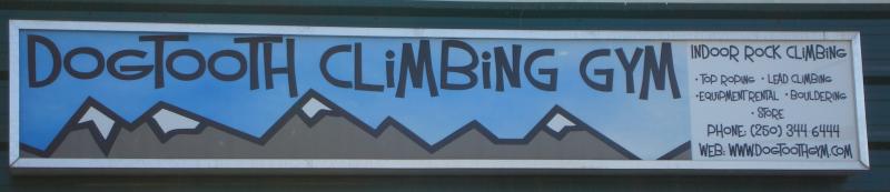

I did this one 2 years ago. White lexan 3/8 inch, clear print material Mactac 9800. We did the side section on right just black lettering in case he wanted to change something. I can get a night pic if ya want.
