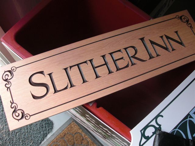

I printed a wood grain pattern last week but instead of wood I printed it on 1/2" pvc. I then put down a paint mask and v-carved my lettering into that, sprayed with Krylon paint and it came out nice.
Printing UV on wood wouldn't soak in. UV inks cure solid on the surface and can't be absorbed.
