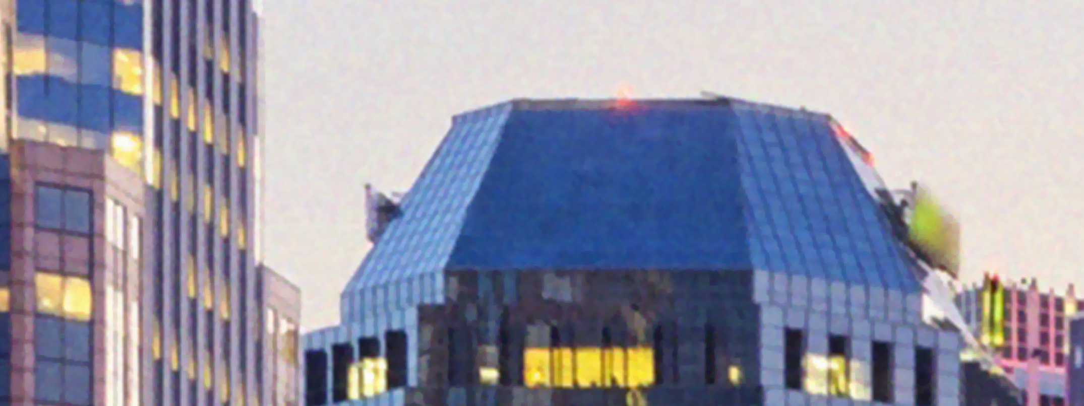

So I've got a skyline mural I am doing and need help resizing the image to create a better resolution. Already working with the best image I can get. 30" wide at 300 dpi. Have already added noise resampled and added smart blur but still not where we need it. Print size is 21'x7.5'. Already trying to manage customers expectations, but trying to exhaust all options at this point to get the best we can get. Attached is a sample with what we've already applied to the native file.

What is "the best image I can get"?
If you're starting with a jpeg your are hamstringed from the get go.
Is it a photo? Is it artwork? What file format is the original image?
Have you done any image editing...aside from trying to fix the resolution?

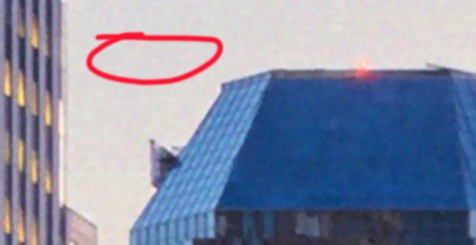

I would avoid "smart blur" It doesn't solve resolution issues, it just makes it look crappy a different way.
When you resize the image in photoshop...are you using the "preserve details 2.0" option in resampling...or just "automatic"?
Preserve details 2.0 is actually pretty damn good.
The trick we often use is we will overshoot our target resolution by 2 or 3 times, then step it back down.
Another important thing is when you apply a noise layer...be sure to use monochromatic noise.
Then you won't get that yellow and pink crap in your highlights.
Lastly, ALWAYS use tifs or .psd for your final output. You want as little compression as possible.
If you go through and try to combat resolution issues, then save as a jpeg...you are just adding more compression on top of compression.
The compression artifacts are what you are battling...not the resolution.

Get a trial of On1 or Gigapixel. While Adobe stuff has gotten better it's no match for dedicated programs.
I've been using On1 for years. If you have a solid image to start with 1000% bigger is very doable.
