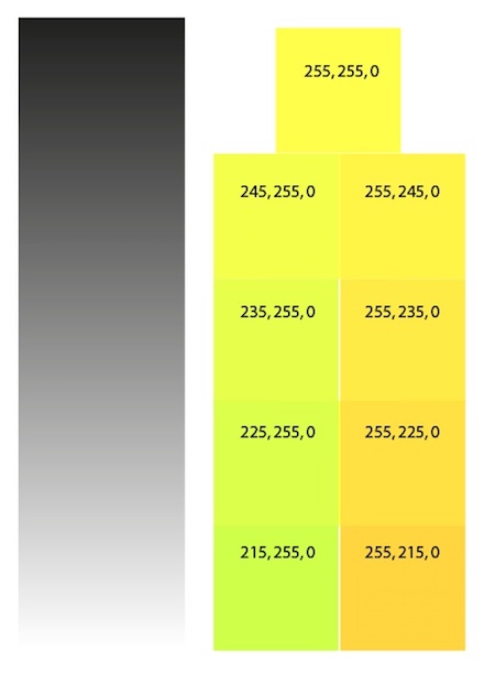

Create a file in RGB mode such as the attached, using the values. Print it. Tell us what happens. Upload a photo if need be.
