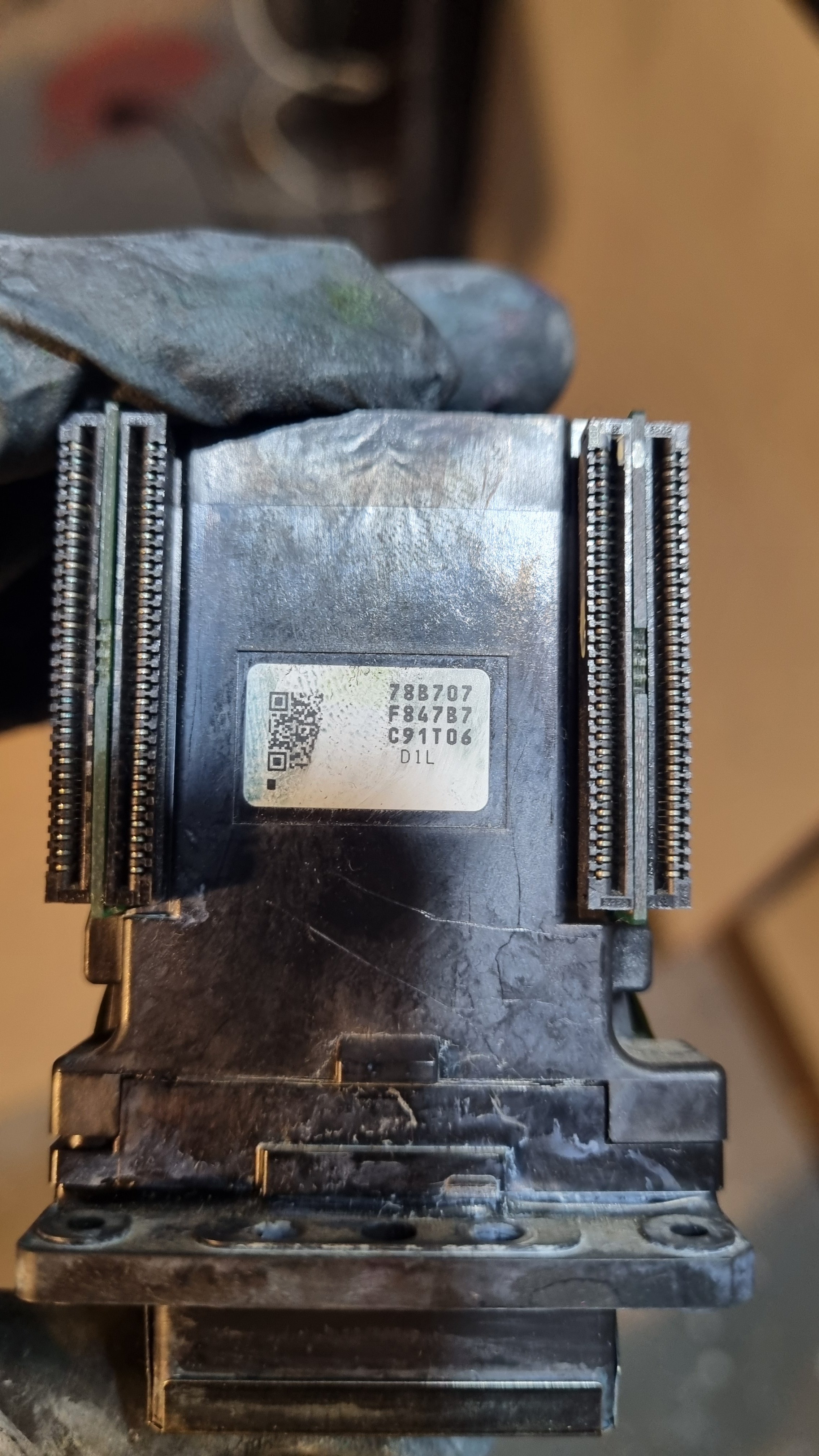

Hello, I have a question. I wanted to make a head change on my vs640 and when I entered the head rank, the machine did not recognize it, that is, it made two blip blip sounds and did not make the changes. I also ran into the problem that the head has fewer numbers than the previous one.
I leave an image of the head PS I don't take any number change on the existing one either
ezequiel
printer desing
with the previous head range it does not emit ink from any channel. He also did not manage to save another head rank number. When trying to change a number that is on the device, it does not allow you to record it. it makes me double blip
damonCA21
The head rank tunes the head, it doesn't make it work or not work. Where did you get the replacement head? Was it from China as they often sell non working used ones as 'refurbished'
You can enter the number from any roland head and the head will still work

El rango está en una etiqueta en el embalaje del cabezal.
El cabezal debería imprimirse con el rango anterior o incorrecto. Probablemente hayas insertado el cabezal de forma incorrecta. La etiqueta blanca debe estar en el lado izquierdo.
if the meaning is correct

No, I don't know its origin, I bought this equipment used, it has a head that is broken in its black delaminated channel. and this other one was given to me by the previous owner, I cleaned it with ultrasound and tried to insert it to see what his response was... but it didn't print anything, it's probably worse than the one it is now

Another question because it does not allow changing the head rank numbers. When you change any number and press enter, the device emits a double beep and it does not change...
damonCA21
Never clean the heads with ultrasound cleaners! They will kill the head straight away
