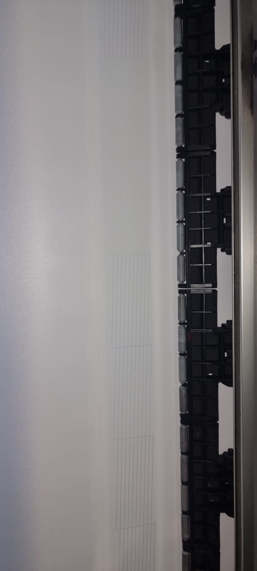

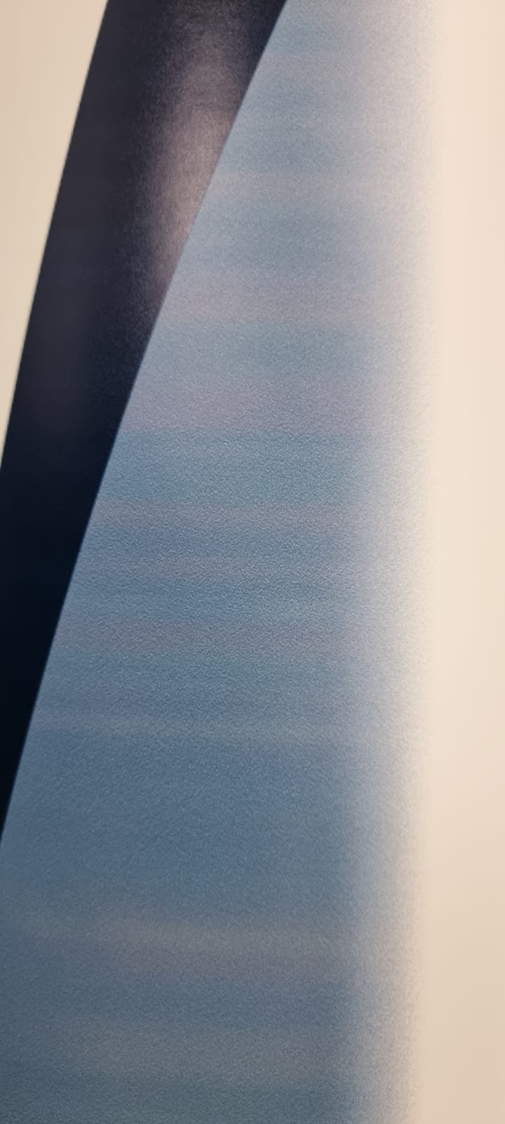

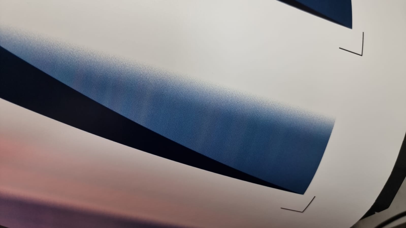

I have a problem that streaks appear in the blue color (as in the picture)
There is a new head
Attached nozzel chack normal
I would appreciate help with anyone encountered

That kind of stripes are usually defective or old media, or vacuum too high (the surface of media become weavy... Not plain). First try a paper media with no vacuum. If it keeps doing it, clean encoder and proceed to the bidir calibration (check manual)
unmateria
Hi :) Na, bad bidir calibrations looks different. Did u check vacuum and replacing media? If vacuum and replacing media doesnt help, try to use a lower printhead distance to the media.
