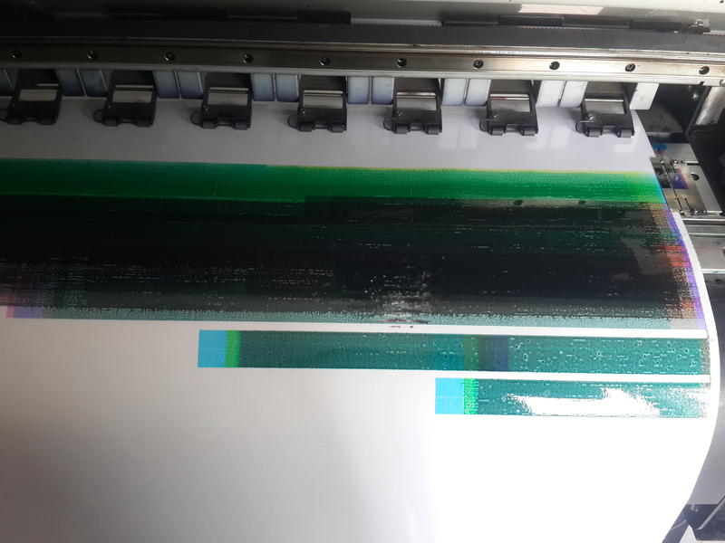

This is what it does now. Start up error 07 the moment the cartridge valves open. So i removed 1 cartridge. Start up fine. Insert cartridge back in. No error. Sometimes it get the error back when valve opens other times not. When no error and i test draw i get like solid blocks printing. Then all of a sudden it picks up linear encoder sensor.
I have not changed the slider as yet. Could it be the slider thats causing this problem.
Attached are images from test draw and actual job sent to print.

getcustomized
Seems your motherboard is still bad. You can contact Kent at Macmedia in NY state for repair he charges about $275 USD plus shipping. he will replace all transistors and such for this price. See you can't just replace the parts in a motherboard that are bad like your friend did. You have to replace all necessary parts and Kent will do that.
Also it never hurts to put in a new slider with new head cables . Even if it wasn't the slider at least you will have a spare as a back up.

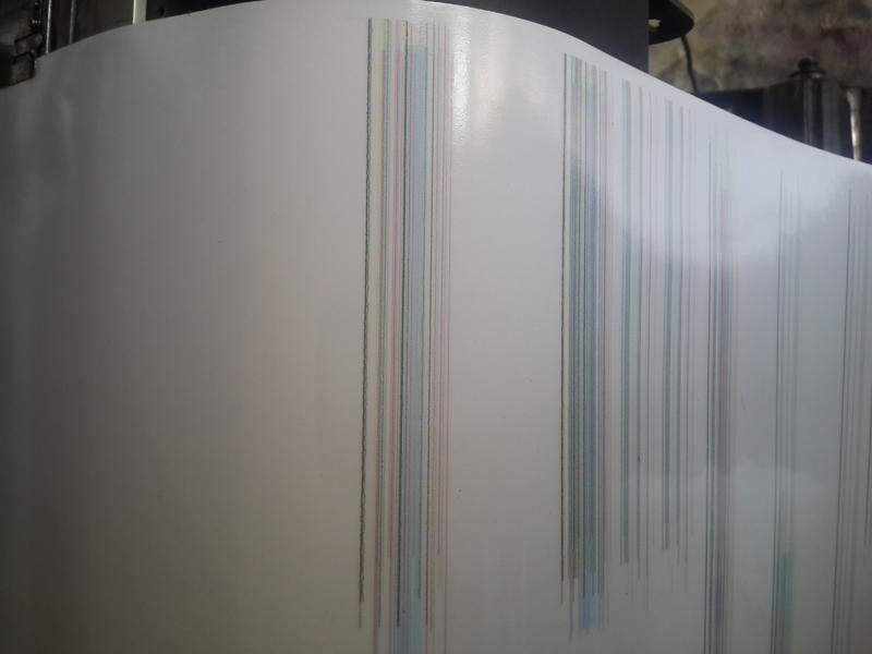

I played with some settings and now prints with just lines as attached image. The test print and actual print are the same. Also. Just to mention the heads im using now are new original dx5 heads. 20161007_151012.jpg
