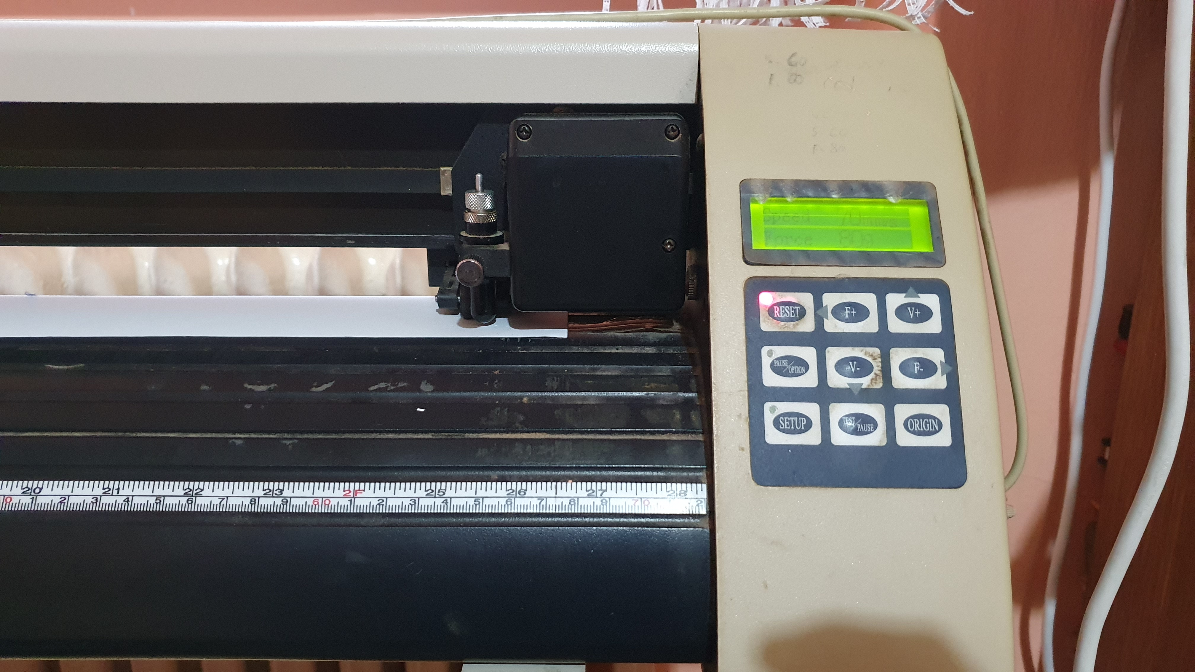

I have an old chinese cutter plotter.Today i want to cut in Artcut 2005 and when i load the plotter not cutting exactly.I use the general cutting force but missing the fonts and dont cut so deep
SOMEBODY HAVE AN IDEA WHAT CAN BE THE PROBLEM?

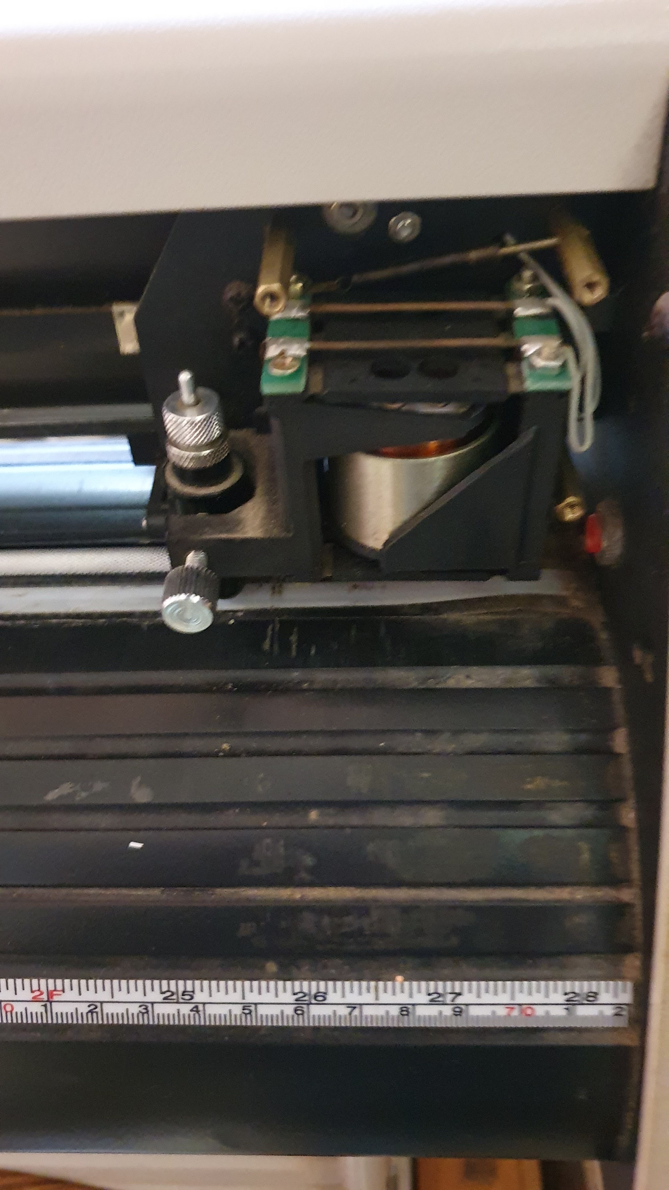

Another picture

Cutting strip can have wear and tear and sometimes needs to be replaced.
Just replacing the knife doesn't help if the strip is shot.

many cutting strips can be turned upside down, (or turned 90 degrees) to expose a fresh virgin surface. if you can do this, you would have immediate gratification

cutting strip.
It amazes me how often they get overlooked and never changed. One accidently too deep cut and the strip is garbage and. A uses the issues you're having... And even if you never cut too deep, it still gets worn out.
Replacing the strip should.be part of your maintenance.... Whether it's every month because you cut rolls, or every 6-12 months because your strip stays prestine. They're cheap, and even if your strip is cutting fine... A new strip can save you tons of time in weeding. It's worth a switch every once in awhile.

Dude there's like 6 people saying to you that the cutting strip can be the issue and you are still asking.
Yes it has fixed issues just like this.
