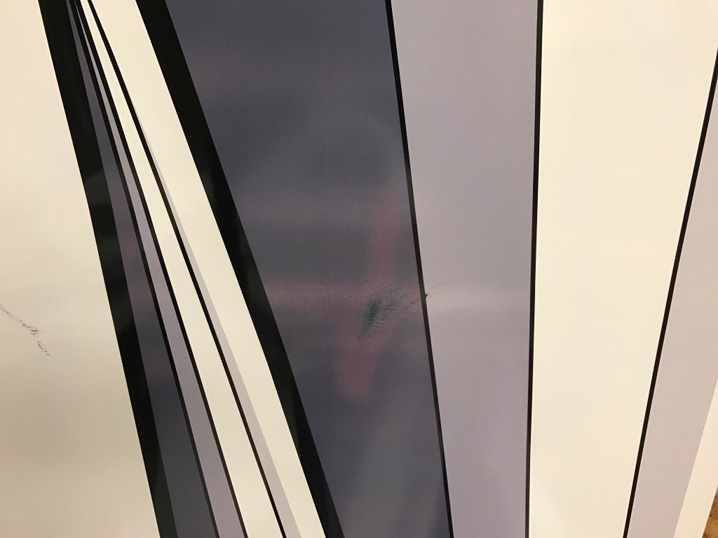

I don't print large decals that often but when I do it seems there are always problems. The material seems to get wavy the further down roll. So this cause inconsistent colors and head strikes on the material. I use media clamps and roll out excess before starting the print. Attached shows the problems I am having. This is the second time I printed this. Seems to start happening about the 4-5 foot mark every time. Don't feel like wasting another 8 feet of material. How do I avoid this?

Need to know what printer and media you are using. Looks like a head strike from the pic I am looking at but it's not completely clear what it is.

It's a SP-300V. The material I'm using is Orajet 3551 RA but that isn't really relevant since this will happen no matter what material I am using. The material starts getting wrinkles in it the further down the roll which is what causes the head strikes and discoloration. That print is about 22 inches wide. After the first one had a similar problem I moved the wheels in to be about 24 inches apart but that obviously didn't help.

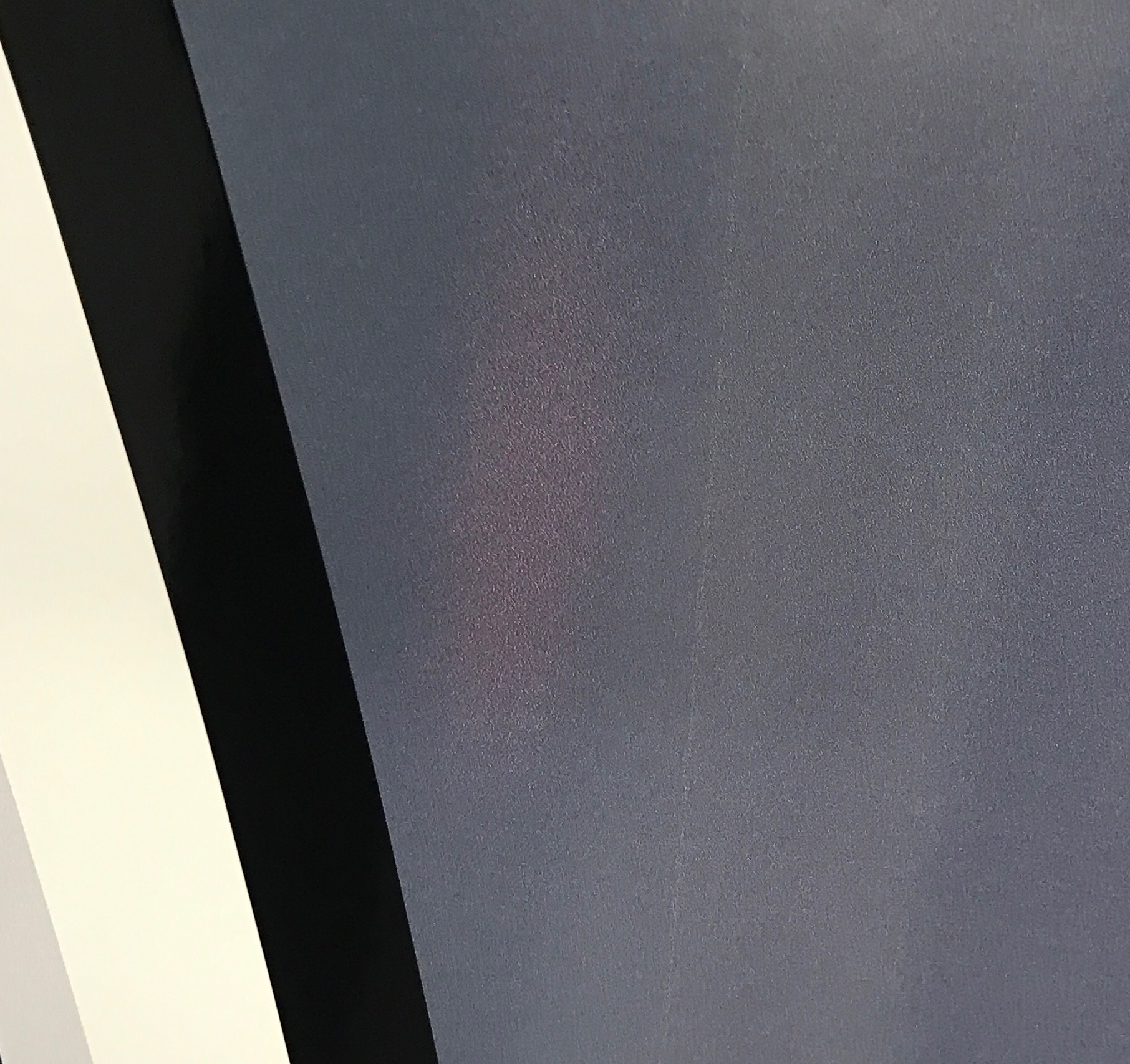

Until my take up reel arrives I did another print making sure there was always tension on the material. But the pink spots still appear and there is always a thin line of pink down the entire length (in this dark gray). See attachment. This may need to be started as a new thread but thought I'd post here first.

I would try turning the print heater down 5 degrees C (do the math if you're using F. That should stop the material from expanding and buckling up in the print area. The less likely cause could be the paper liner absorbing moisture out of the air, or a combination of the two.
Lastly, check your outside pinchwheels - if they're worn down, they could cause this as well and an SP-300v could have quite a few miles on those little tires. Replace them if in doubt.
Good luck.

I know the pinchwheels are good since I just replaced them last month. Made a world of difference on cut accuracy! This last print didn't seem to buckle at all since I kept pressure on the roll the entire time. Now just trying to figure out the pink spots/pink line. Since the line is so spot on with every pass I'm wondering if there is a calibration issue. Thanks for all the input.

Joe House is getting you on the right track. Your media is buckling which causes the issue you are having. When the media buckles, the ink hit's those spots sooner than it is supposed to which makes a pattern that looks like a combination of ink drop out and bad alignments. Heat settings that are too high is usually what the problem is. But pinch rollers also contribute. Also, vacuum out your platen. Dust builds up in the vacuum fans and it causes the vacuums to not pull hard enough to hold the media flat. This is common the older the machine is and tends to be overlooked as a maintenance item.
I saw this after I responded. If the line is consistently in the same place, you need to clean your encoder strip or replace it.

Didn't think about the dust. That sounds like a good thing to try. I'll try cleaning the encoder strip to see if that helps too. It hasn't been replaced in a while but I clean it regularly. Just odd that this line is only noticeable on grays/silvers.
