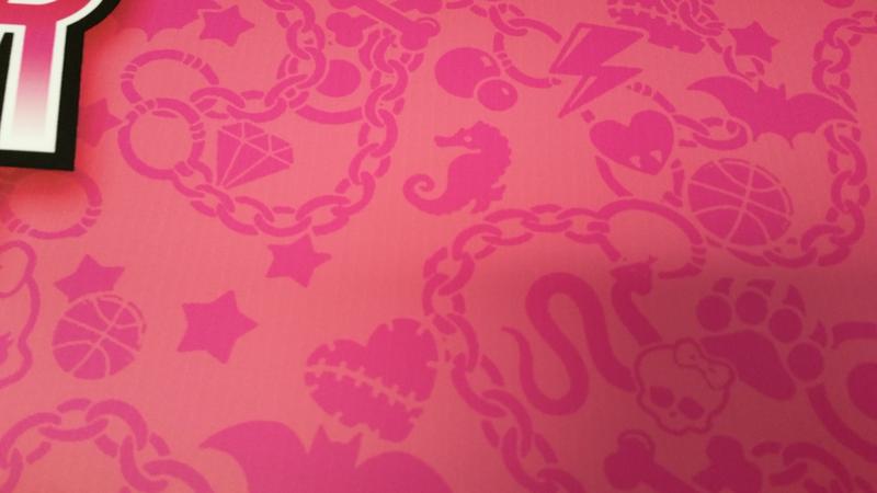

1) Color shift of up to 10-15 shades different on the same file.

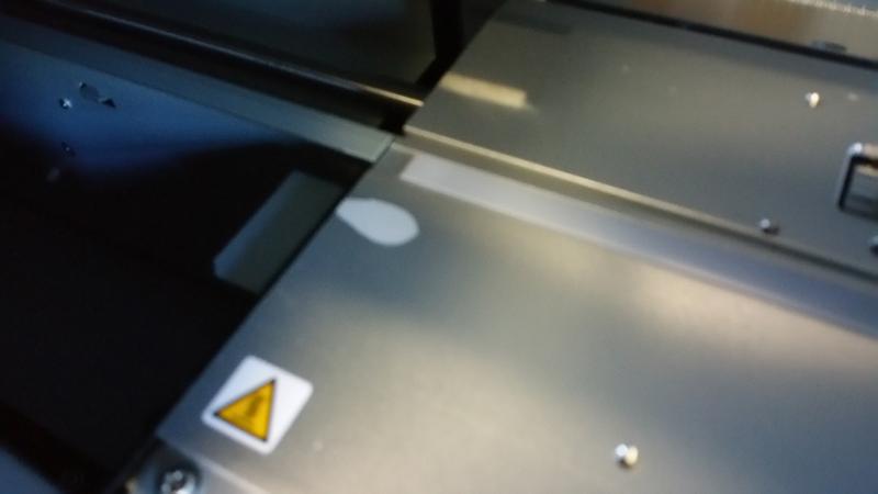

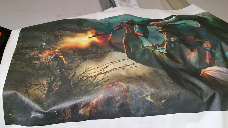

2) Ink blobs would fall on the print or on the platen at will for nor reason

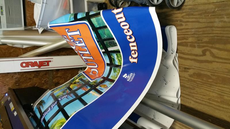

4) The printer will start banding in the middle of the print, there is no rhyme or reason. Sometimes it has dark lines and sometimes it has white lines.

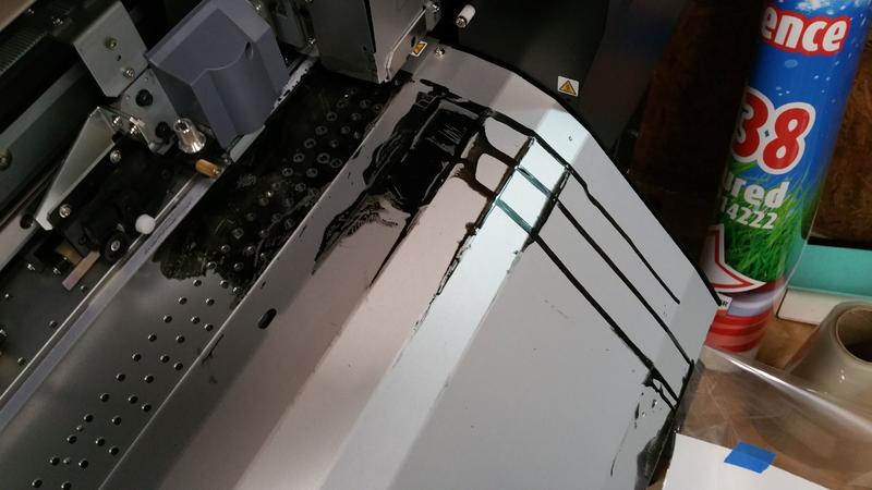

I came in this Monday to black ink literally poring out of the printer on to the platen and on to the ground and all jack said is that I need to sign the form with the false info, If I want the printer replaced.

just out of curiosity, worth a try
Banding and random ink drops may be because of bad damper/s.
After changing the dampers more relevant tests can be made to figure out the different color tones.
