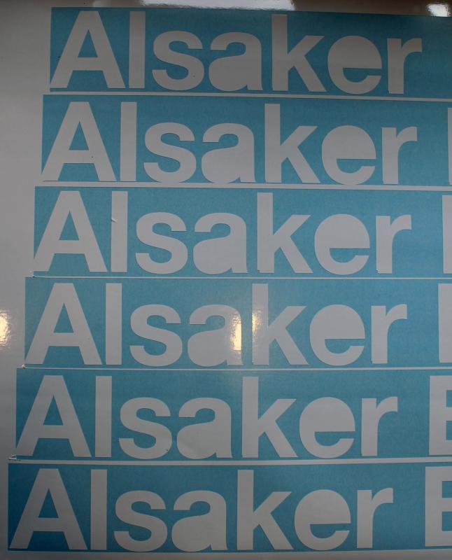

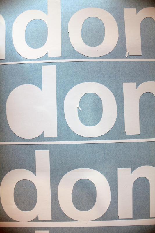

Luckily I use the search function before starting new threads, because I was just about to make a new thread stating ALL of the symptoms in the first post here! I have a GX-24 with just the same problems all off a sudden.
Looks like this when its cutting:
http://www.youtube.com/watch?v=99XqU25A-bs

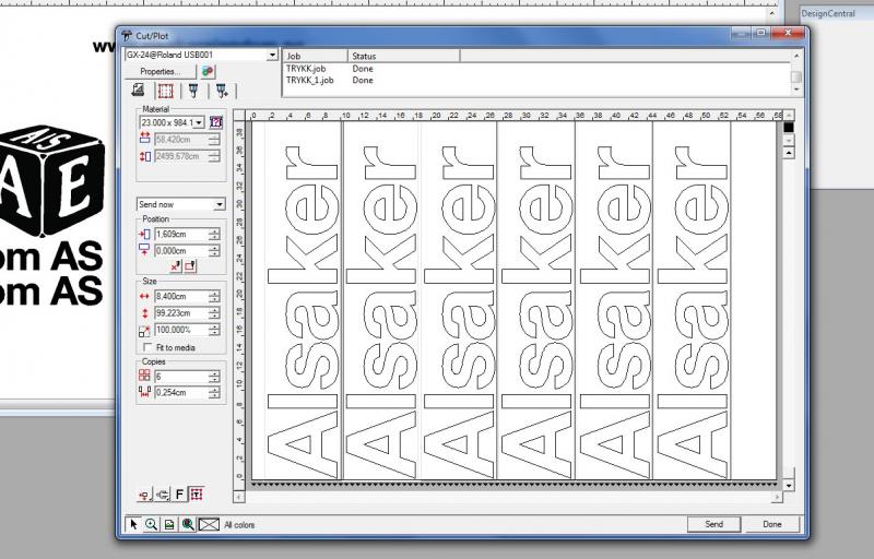

And here are some pics of how the file is set up in flexi to how it comes out of the plotter(below)
Wondering if the spray still solves the problem, and maybe what a permanent fix might be? Judging from the amount of application tape I've used up since getting the plotter, I've cut at least 500 yards worth of small stickers without any issues, until this last week when it developed all the symptoms described in the first post.

Haakon
I don't think either of those options could explain the bad tracking? On small details yes, but if you see the difference on the first and second image, all the cuts should start on a straight line, but they are staggered almost half an inch for every repeat cut.
Haakon
Update, got hold of this spray from a audiophile friend (remembered he bought it when we were flatmates while I studied graphic design years back), http://www.nordost.com/ECO-3-P67.asp and it worked like a charm! Now it runs as smoothly as ever, and I got to finish my order. Weird problem and weird solution, but it works! :)
