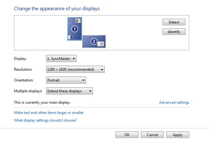

It definitely looks to be a monitor resolution issue but there is no way of changing it in display preferences as it's set to one resolution only. The printer didn't come with a pc so I'm having to load it onto the one we already have here
artbot
do you have a second monitor that can be plugged in? when a pc sees two monitors, it will see them as a composite resolution for window placement. after plugging in the second monitor, go to screen resolution, drag one monitor very high compared to the other or rotate one 90degrees. doing this will reveal parts of the window that are currently in the cyberspace of your "desktop".
