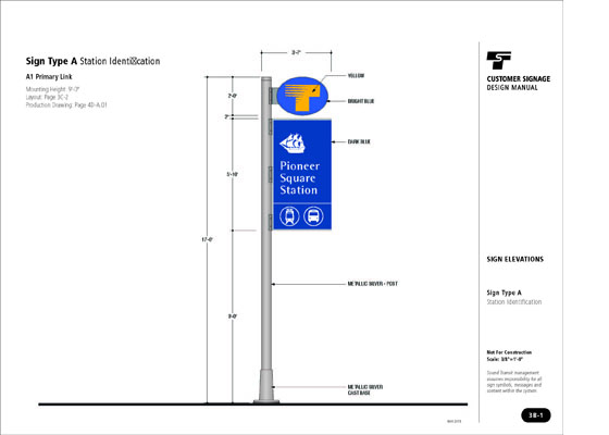

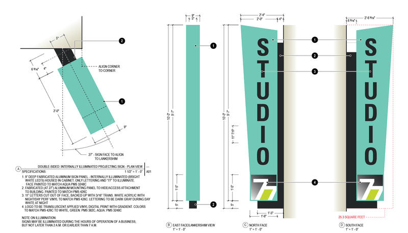

Hello. I have a client that I need to be providing "cad-like" drawings. I currently use Flexi and Illustrator CC for design.
They don't need to be blueprints, but to have that same look. I attached a couple of samples I found online.
What software do you all reccomend? AutoCAD? Or is there something similar that is just meant for renderings like these.

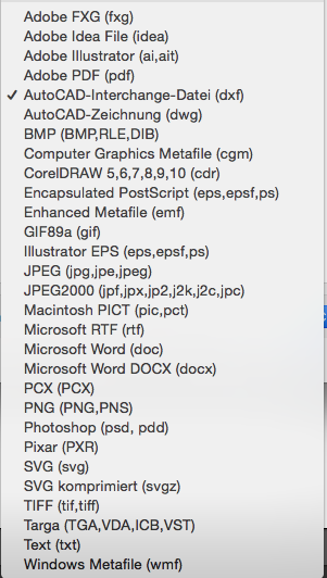

s500
far as I know, can import DXF Illu
