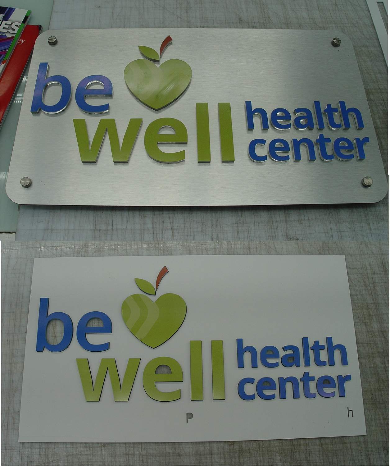

I have had a sample of Oracal pvc free film and laminate for a while and just did an acrylic cutout logo and lettering after I applied the print to the acrylic- then cut a thin styrene template for placement on the brushed ACM backing panel. It was easy, efficient and looks nice. I would like to pursue this type of sign but the Oracal only comes in 54 and 64" [I think] rolls and would be more cost effective at 30" as the sample was. The parts are nested and do not require that wide material. Anyone have an alternative or want to split a roll with me? I 'think' that a spray can Polyurethane clear coat would be easier too- cut, leave in the panel and spray? Thanks Gene
