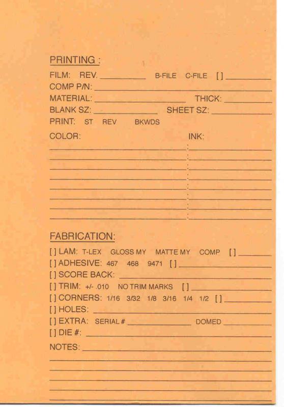

we have paperwork with all the job info
we have job folders with all the info
we have proof sheets
and still we get mistakes(spelling, material, colors, films, corner radius, shipping, and so on...)
it just depends on your people if you have good people who care working for you then your mistakes should be minimal but if your people are just collecting a pay check and are clock watchers and sit around thinking what you owe them
then you could have a lot of silly and or dumb mistakes
here is a copy of our job folder if that helps any
