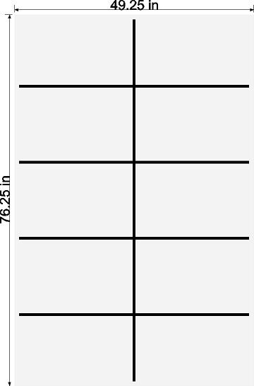

This is what it looks like -

Is it supposed to simulate muntins? Get a 4x8 sheet of black 040 aluminum, shear the strips and adhere them to the glass somehow. That's all they are on regular single pane aluminum windows.

That's so small, why not tape it off and use some industrial grade oil based paint and go to it ?? Don't forget to wear a hat.
That could work too - need to check that the paint would be compatible with the poly car - Don't need a hat we would do it here in Ohio
What do you do with the rest of the sheet? I'd route the shape out of the whole sheet and do full coverage with 3m 467mp, it'll keep water from getting trapped and freezing, but it's also got terrific holding power. 2" poly isn't going to expand that much.
But straight up 3m 7725 black would be the way to go. It won't last 10 years, but not much will these days...

Oh right, I meant to throw something snarky in there about it being unnecessary for freezing purposes, glad you caught me!
But really, either adhesive or tape, it'll need full coverage or you'll eventually be staring up at dirty lines around tape bits or glue streaks.
