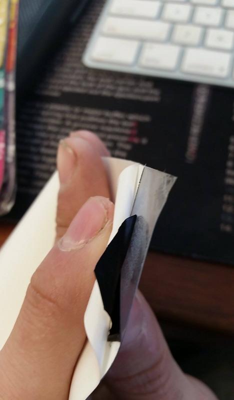

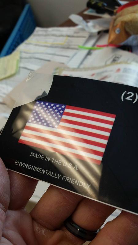

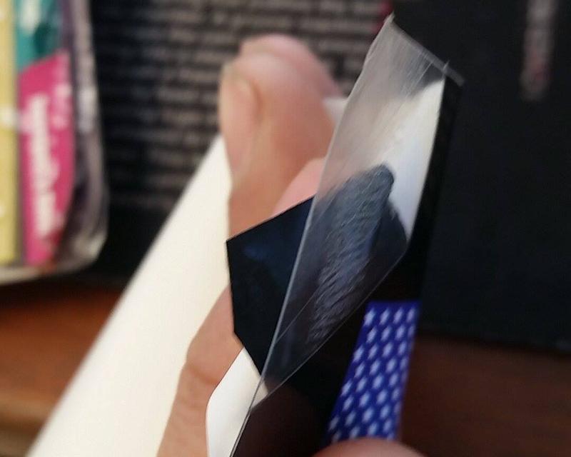

I just pulled a corner off and there is definitely adhesive, or at least it is tacky anyways. I dont know how the thermal ones work..

Long shot here, but we use 3M 8991 for graffiti protection. It's expensive, but it's high gloss, thick, rigid, and sounds very similar.

If they are screenprinted decals such as from Stouse then they may have a clear polyester laminate. This laminate is very rigid unlike vinyl (PVC) lam films.

Maybe Oracal 210 gloss lam?
210 is half as thick as what he's talking about and is not rigid enough to peel the corner like that and keep it's shape, nor is it that brilliant. I use 210 every day.

It looks like an 8 to 10 mil polycarbonate film to me, I can tell you it is a major league PITA to plot anything other than squares or rectangles on.
