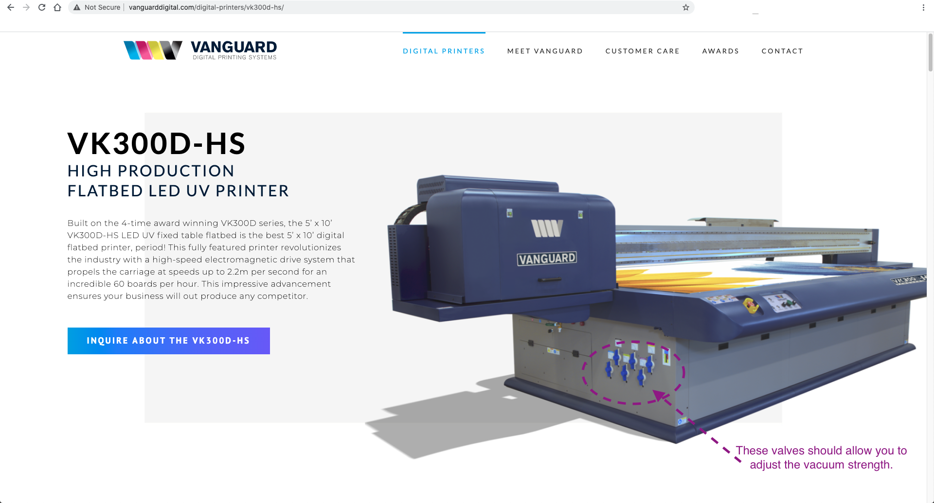

Also, while I'm not a Vanguard owner (I own a CET which use to be most of the staff at Vanguard) the vacuum system is adjustable so I would think you could turn down the vacuum by adjusting the flow valves on the side of the VK300D - we have to do this on our CET when the vacuum is too strong.

I'll ask the rep about the adjustable vacuum, thanks for that.
