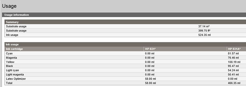

Answers:
1) The HP Latex machines can sit without printing for a lengthy period of time without printing. I have gone several weeks at a time with no issues. Be aware that the machine should be powered on at all times and not shut down over weekends or evenings. It will go into a low power sleep state when not is use.
2) Your ink usage will vary significantly based on the media that you print on and the area coverage. In most cases, you will find a range between 1 and 1.5 ml per square foot is very accurate. This works out to between $.15 and $.23 for ink psf. See attached capture of the ink metrics taken from Latex 360 in my office that has been in service for about 1 month in a training (non-production) environment.
3) There are t-shirt transfer media products available for HP Latex inks from multiple manufacturers.
