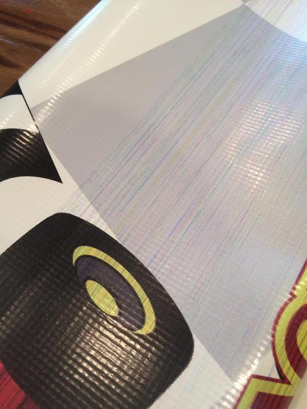

So mid way through a print we will get random streaks of solid cyan, magenta, yellow, and black. This has happened before and we cleaned the print heads, that seemed to have fixed the problem. But within a week it happened again. Photos I've seen of ink dragging don't look this bad. Is this just a case of extreme ink dragging has anyone else had this problem? We are printing with a Roland Versacamm SP-540i.

Looks like the heads aren't sealing when they aren't needed, and drips hanging off the heads causing streaks. Too much pump pressure going out? Not enough vacuum holding it in?
And yeah, this looks like a problem a bit beyond the typical operator.

I don't believe this to be a hardware issue, in my experience with my SP540i, this is a network issue. For lack of a better description, there is occasional *noise* on the network and it's interfering.
My guess is that you are using a wireless connection. If so, set up a wired connection with a static IP address.
StickyBandit
Definitely a network issue. I had a wireless connection and had the same issue. The second we went wired the problem stopped.

does your printer have a wiper mechanism to clean the printheads, that's caked-up with ink? or maybe your printheads are so gummed-up with excess ink around the edges/sides?
suggestions above are legit, but the thought just occurred to me that maybe you're just in need of some thorough cleaning.

So we called in a tech. MANY things were wrong with our printer. The tech said it could have been caused by many of the things that were wrong with our printer. He had to replace one of the print heads, another will need to be changed within a year or so. He said to ALWAYS use a wired connection. The wipers were recently changed, however the rest of the machine was in such a mess that they were not able to do their job properly. It seems to be a mix of everything everyone suggested.
Just a little background, I just started this job two weeks ago (only production experience was in school, none essentially), the company has had the printer for three years and they have never called a tech in, and had only cleaned it maybe twice during those three years. So needless to say the printer needed some real tender love and care. Print heads were super gross, looked like someone dipped them in jam. But after the tech gave it a deep cleaning he said everything is back to where it should be, and as long as we continue to clean it on a regular basis it should print fine. So beginning next week time is now being set aside every Monday so I can maintain the cleanliness. The original production guy had no experience either so he just let everything go. Maybe now that I am here things will go smoother from here on out.
