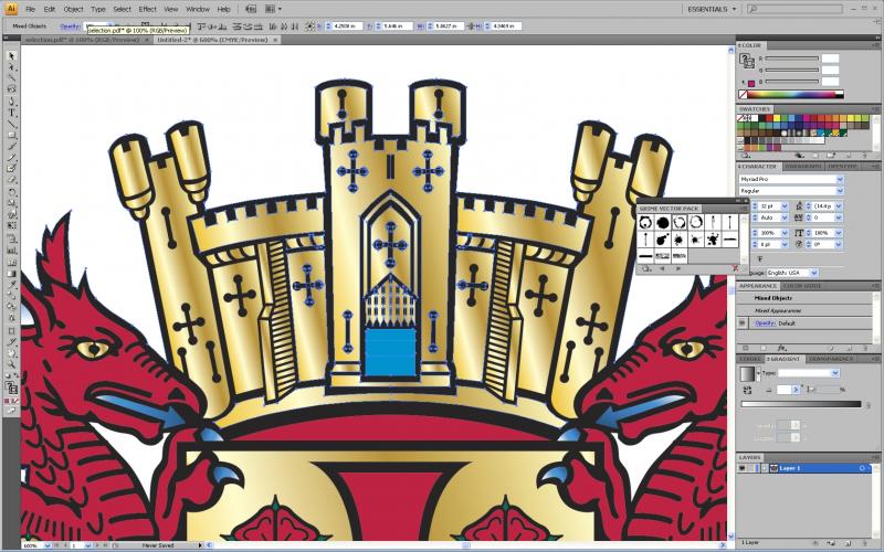

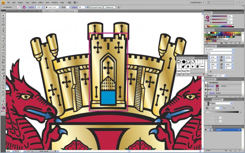

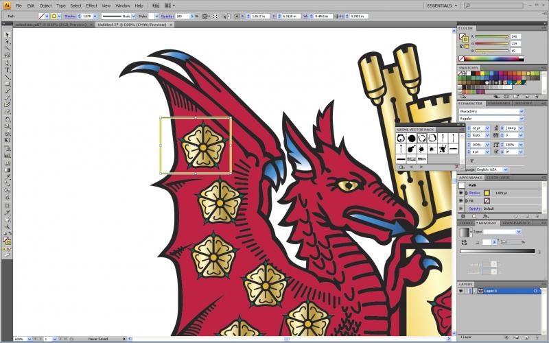

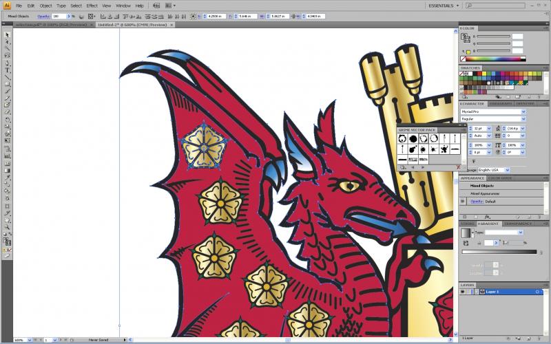

Here's a better real world type example of what I'm talking about and dealing with.
The first photo is what I want to capture (and what I would capture by using the selection tool in Corel). The second photo is of what WAS captured and what I'll have to figure out how to deselect.
It's 2 examples from different parts of the graphic.
I hope this better explains what I'm talking about.
