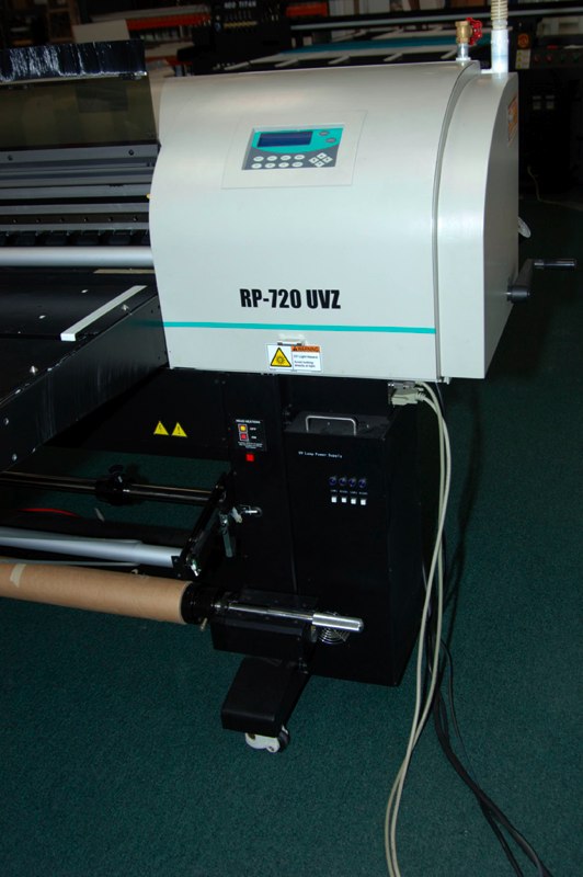

Anyone know this printer very well?
Raster Printer UVZ720

SignManiac
It was my first UV flatbed back in 2006...Total piece of crap. After six months of trying to get it to print I gave up and forced the seller to take it back. I ended up losing about $10k over the six month it was in my shop. Left a bad taste in my mouth.

I have a Raster 720UVZ for sale for $8k. This machine went for near 60k not but a few years ago. PM me for more details.
SignManiac
You had better have a real passion for tinkering and all things mechanical to keep it running. I had a hard time keeping it dialed in and calibrated. Good luck
Dani Plotter
We have installed 6 of these printers in my customers. All of them are working but they needed a lot of repairs. If you are to print only roll to roll, It is a good machine. The weakness is in the electronic boards, they are not very stable I recommend to put a voltage regulator. Be sure the print heads are in a good status.
