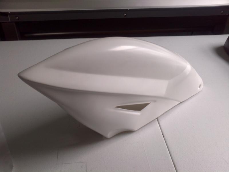

I'm thinking about starting to get into wrPs of RC vehicles. Starting with helicopters. I called mactac and they reccomended roughrap after seeing a picture of what I was a plying to because of the conform it and size. I was wondering if anyone had any suggestions of material and method to try to apply material to these. Here is a picture of the sample my customer gave me to play with.
Thanks for any help.

lamination should protect the ink, and i doubt weight would be much a factor. these machines have close to 4 HP and only weigh 9lbs. they can actually carry more than they weigh! ive just got to figure out what material will conform the best, and come up with some radical designs.

is there anything that is very conformable that can stick to polycarb? the helicopter bodies i am looking at are fiberglass, which should take vinyl well i believe.

Most of the bigger Heli's use fiberglass, I use a MX type of base materials for the bodies.
