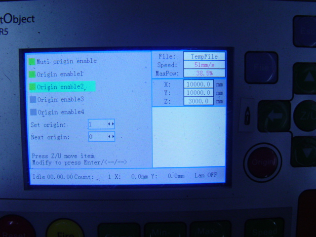

So here is something I have always wondered about and not been able to get to function- this screen in the Z/U menu under 'Origin Set'- it is obviously possible to set up four distinct origins and then command the machine to return to them... but how to set them and then be able to return to them. Thanks Gene
