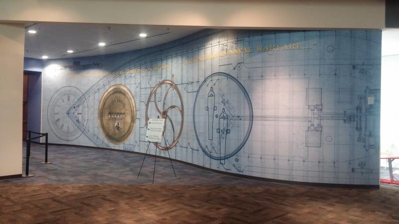

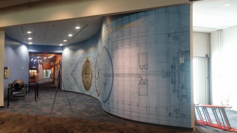

This is a recent job we did for the Mariners' Museum. The wall was 14' tall and 50' long and had a slight s-curve to it. We used the Phototex exs on this job. It was the first time using the exs and it worked very good.

We just installed this last week. This is the hall that leads to the Monitor exhibit. We do a good amount of work there and for the Noland trail.

The first curve was a little trouble for lining up the first two pieces. After that it wasn't enough to cause a problem. It was printed in 12 52''wide vertical pieces on a hp8000. No liquid laminate was used.
The EXS is just a higher tack version for the solvent printer. It is not any more opaque then the regular phototex.

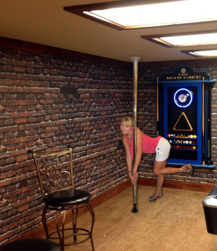

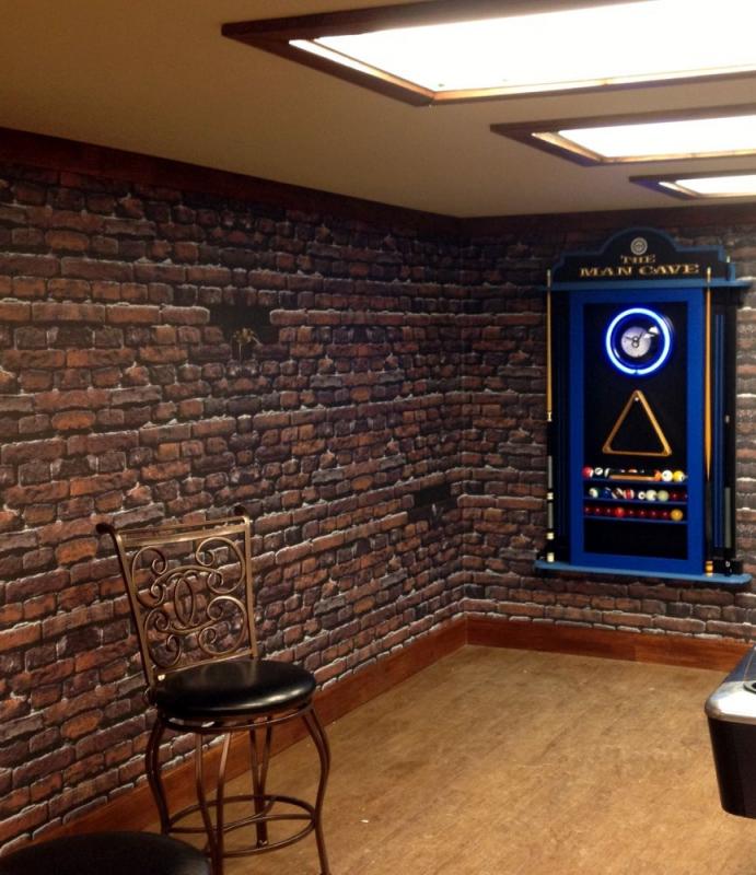

Although I'm a big fan of PhotoTex, I have found that it can be problematic on knock down textured walls. I used the high tack on my man cave wall and have noticed in areas where it's not adhering at all. The spots look like blisters where it lifted. It can't fall off because I used trim over it top and bottom but I think it's better suited for flatter surfaces. But the material itself is very nice. My wall is an extreme application.
