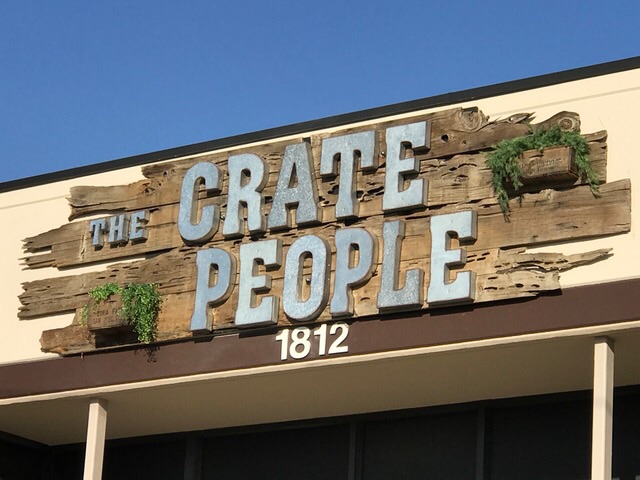

So I have recently been approached by a couple customers requesting this reclaimed wood style of sign with dimensional letters. I have been told that these can be difficult to get permitted as they need to have fire retardant wood and whatnot. I am more interested in what is the nuts and bolts way to put this together? What backing substrate and what not?
Thanks

If a coating is going to be used, you might need to find out what Fire Rating it needs to pass. You would be fine if it makes the wood Fire Rated "A" - just document the materials used when submitting for permits.
Personally, I would probably not slap wood against the structure. I would make a frame and attach the wood to that, then hang the structure as a unit... giving the wood and structure a barrier for even more protection.

sculp it all in HDU and give it a faux finish on a alumipanel backing
