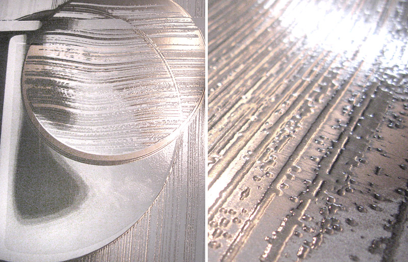

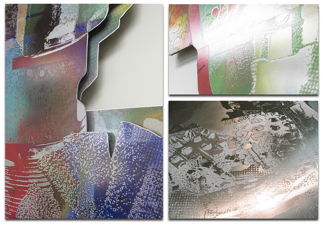

thanks for all the info guys! sounds like all i need to do is bump my budget up a few grand and i'm in with an older machine. that acuity does look good in that i've seen youtube vids of it and it seems to have good visibility. i like to hang over my sheets and see what's going on. also, it seemed to run "quiet". not really quiet but not as loud as others. when my machine is running it sounds like a tornado is outside (two blowers, an air scrubber, and the vacuum vent on the printer, plus y motors).
i like the sound of thick ink that can stand up. my ink can go on really thick, i sell it as a product i call digi-boss. if i really glop it on, it's thick but reduces detail. putting it on twice at medium thickness would be crisp and even deeper texture.

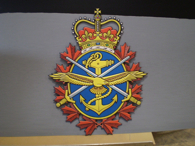

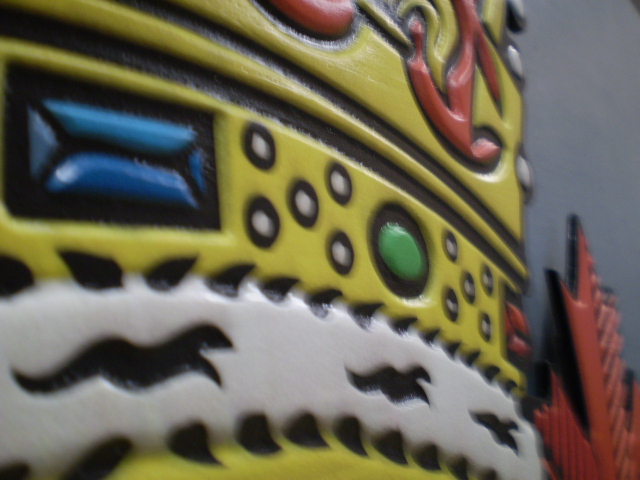

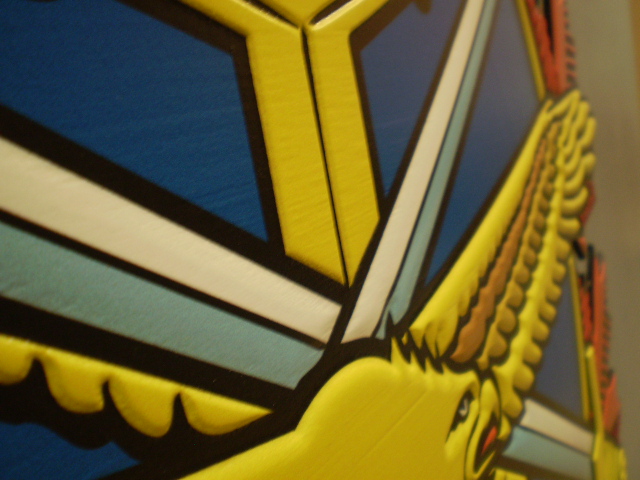

this was printed on our Accuity.
1/4 in from highest to lowest point.

that is really really impressive! very nice work! the ink looks really thick and opaque! i may go back to cmyk if i could get some color like that.
with such thick ink is the issue of fading still a problem? my projects go in hospitals and such (indoors sometimes with bright sunlight coming through glass ceilings). the commercial projects want their temporary art to last 15 years, but larger pieces (mine) over 50 years. so i like to stick with solid long term pigments.

As for longevity, we've had the machine for 2 years only, so kinda hard to say. This particular project has a waterbased clear on top.
We do, however, print bus panels when our Inca Columbia Turbo is down. And so far, ink seems to hold up very well. At least way better then the Inca.
