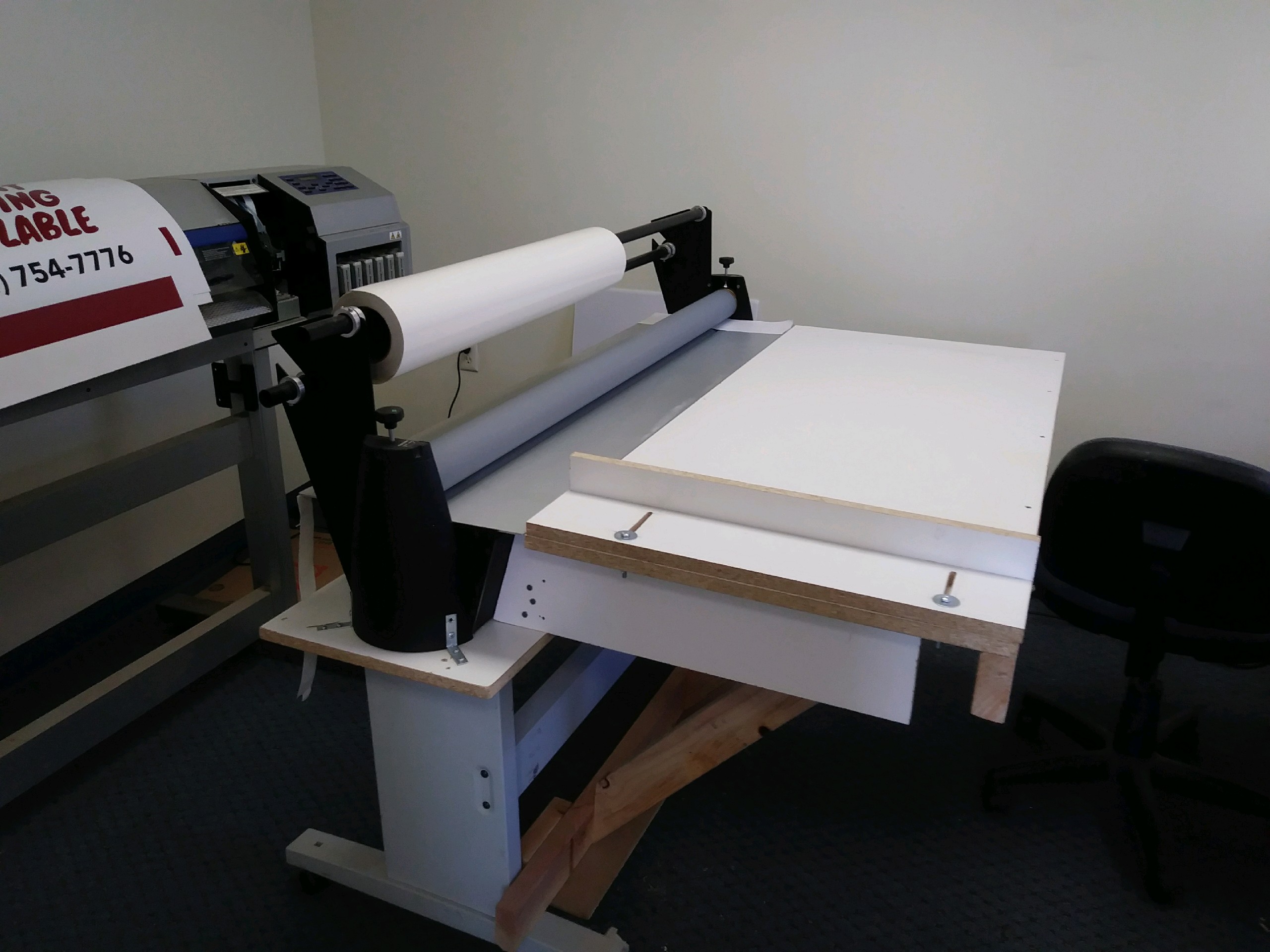

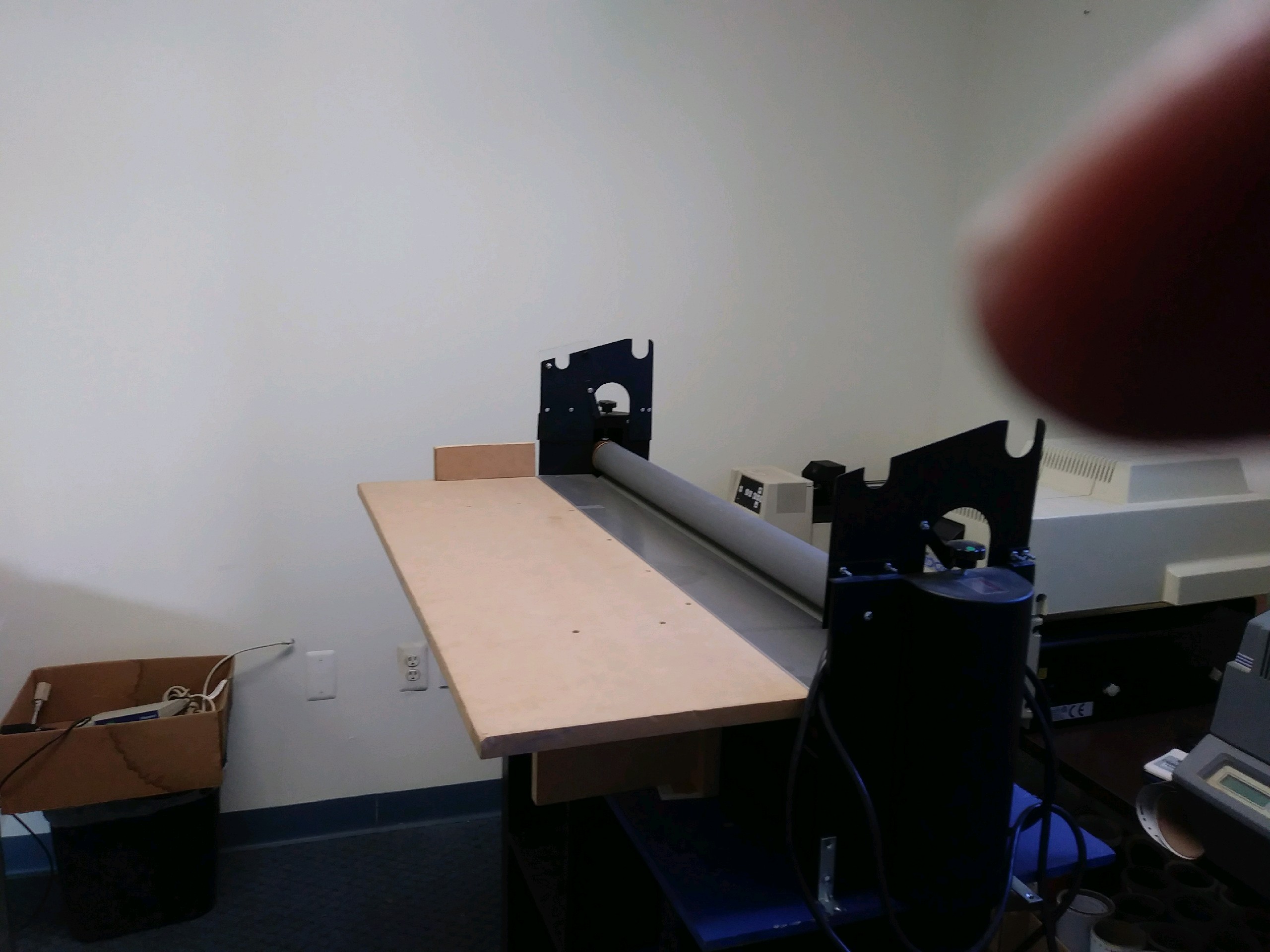

we had a lot of trouble getting used to the daiges, so we made a slight modification

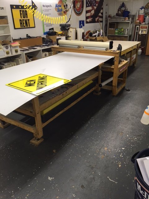

Daige 54" Solo laminater is what I use. It takes some getting used to, to make it work right, but we like it. I have 4ft x8ft tables in front and behind the laminator, built to the height to match the wood base I set the lamintor on and we apply laminated to decals then use the same Daige laminator to
apply the decals to material such as coroplast, pvc and max metal panels. We can do 4ft x 8ft or even larger. I bought 2 of the Daige laminators and keep one as a backup.
I can change it out in 15 minutes and get back to laminating while waiting on a part to fix the broken laminator. Low cost way to laminate.
