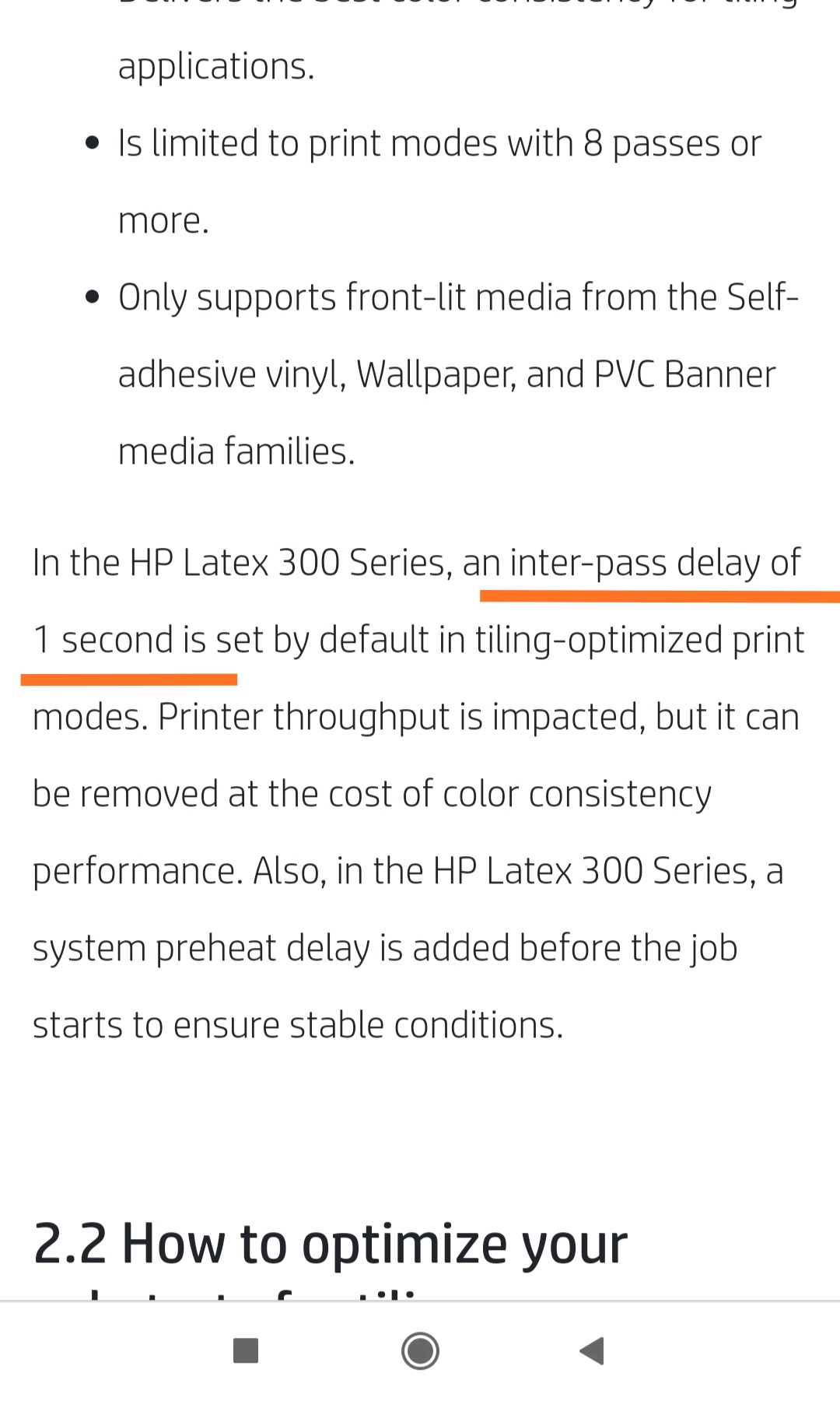

jimmmi
The tiling mode automatically adds 1 second delay for some reason and in hp recommendations says that is for stabilize ink better. I just reduced to 0.5 beacuse its too slow.

jimmmi
Hmm okay, didn't know that. Maybe its useful after all. Just slows down the printing heck a lot.
Definitely that's why i changed to 0.5. Hopefully it will do the same.
Attached the info from hp. Basically they say for 300 series. Maybe 500 is different because of different curing unit IMG_20210526_214820.jpg
