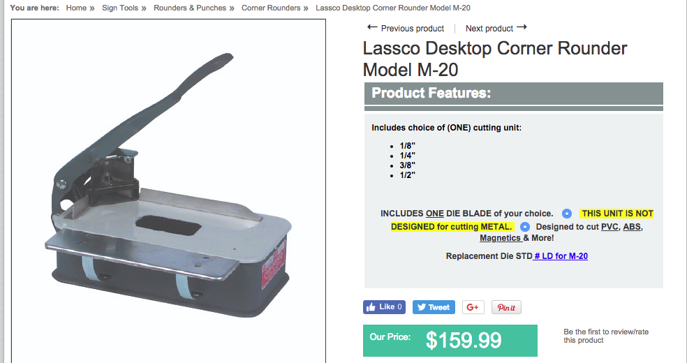

We use this for thin gauge aluminum, magnetic, ACM, styrene, 3mm and less PVC, coroplast, etc.

gabagoo
I have had one of these for over 20 years and it still works great. Can buy different size dies as well. I think it is probably the cheapest corner rounder you will find.
TimToad
For the money and our volume it's perfectly adequate. If we started doing a bigger volume of things needing a more robust tool, we'd buy it.
