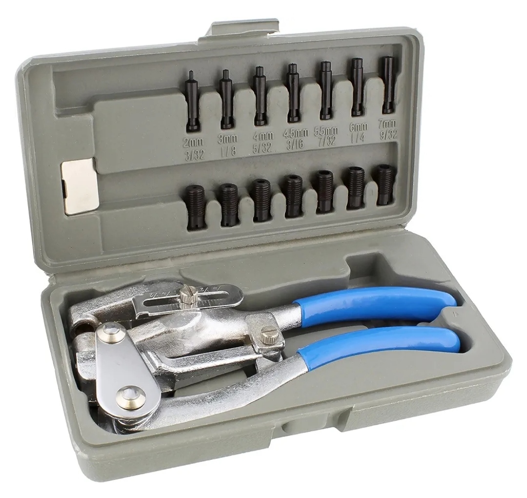

Hey! I know this is an old comment, but how has this punch held up? Would you happen to have a link to it on the Harbor Freight site? Or maybe a photo? Thanks in advanced!
ChicagoGraphics
I used this one for years and it also came with an attachment for making slotted holes, I paid under $50 for it
