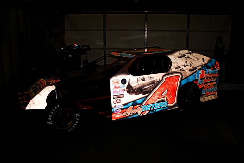

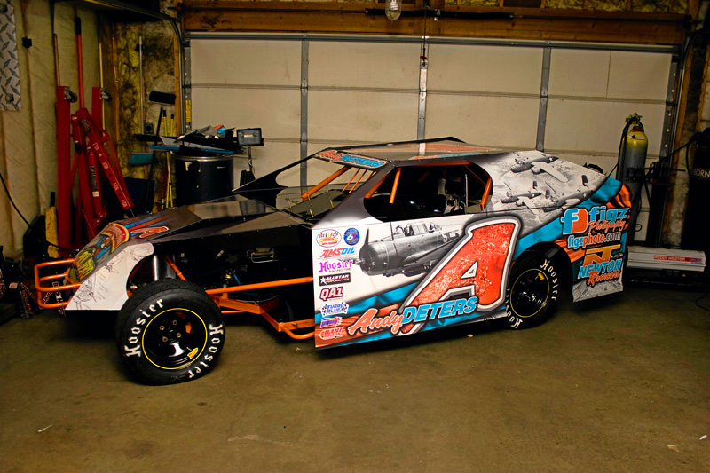

My Brother's racecar he built. I did this with Oracal 5100 if I remember correctly.
