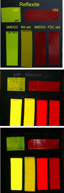

I'm surprised when someone says this. I've never seen that to be the case. Years ago I did an unscientific photo test of Reflexite, 3M DG3 and FDC's engineer grade. Photo flash from across the room, nothing else:
I've never found Reflexite to be that particularly bright, even compared to standard engineer grade stuff. But to each their own - it does satisfy NFPA requirements.
