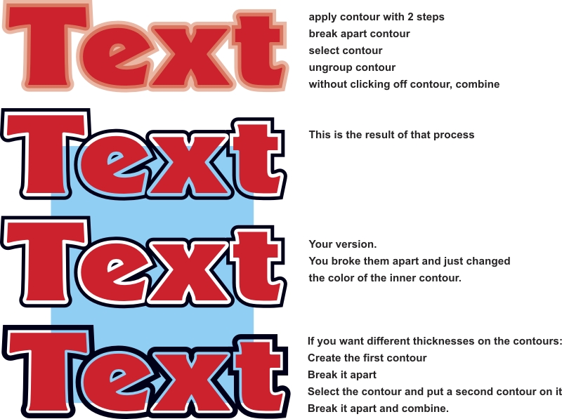

Here is a visual of the process. I put 50% cyan behind the layouts so you can see the difference between what you did and what learned the hard way suggested.
