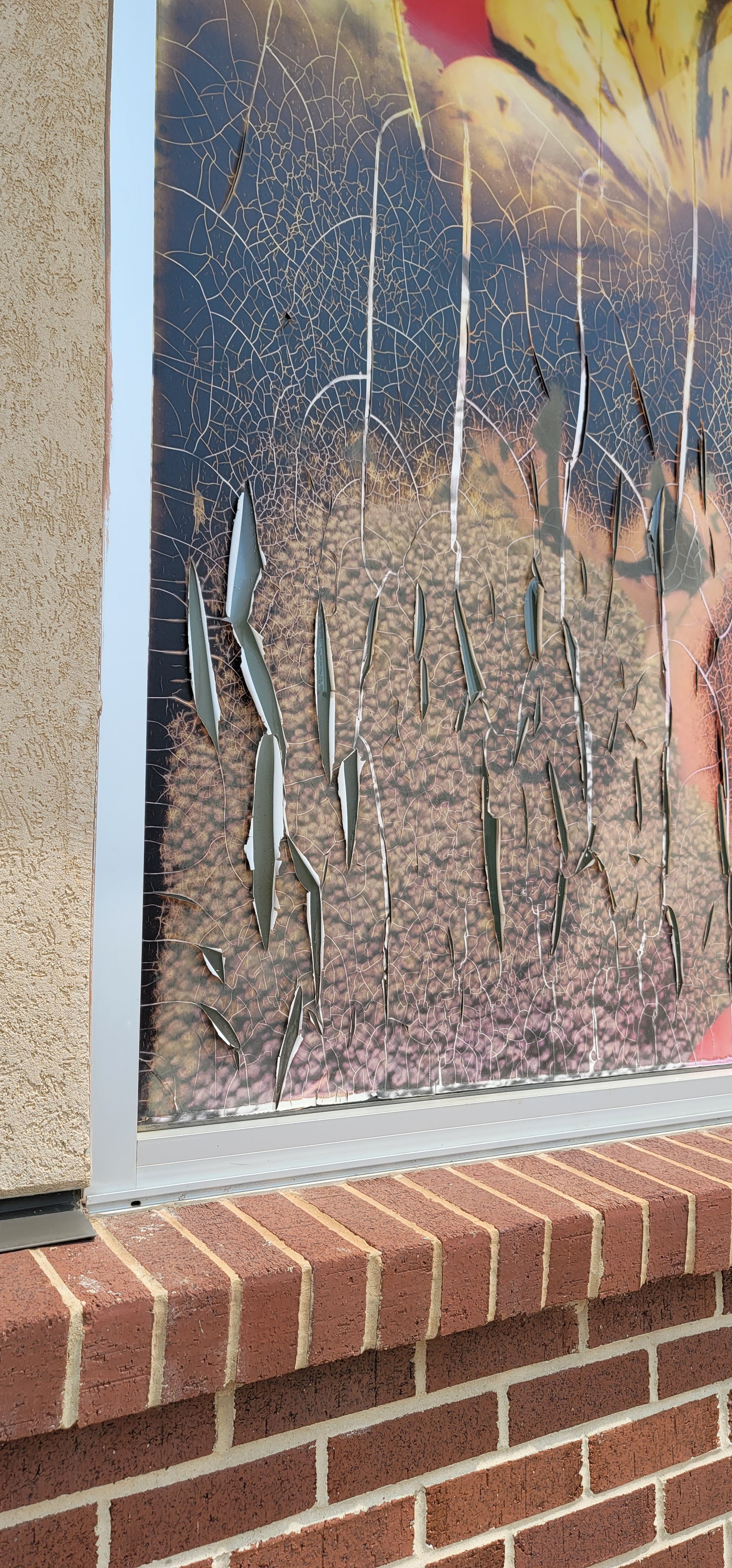

Is that gray stuff behind decal a block out layer? would love to hear how it went. I have seen material look like a nightmare and the come off easy and look easy then turn into a nightmare. That picture appears as if the majority is the laminate cracking and the vinyl the secondary cracks.
